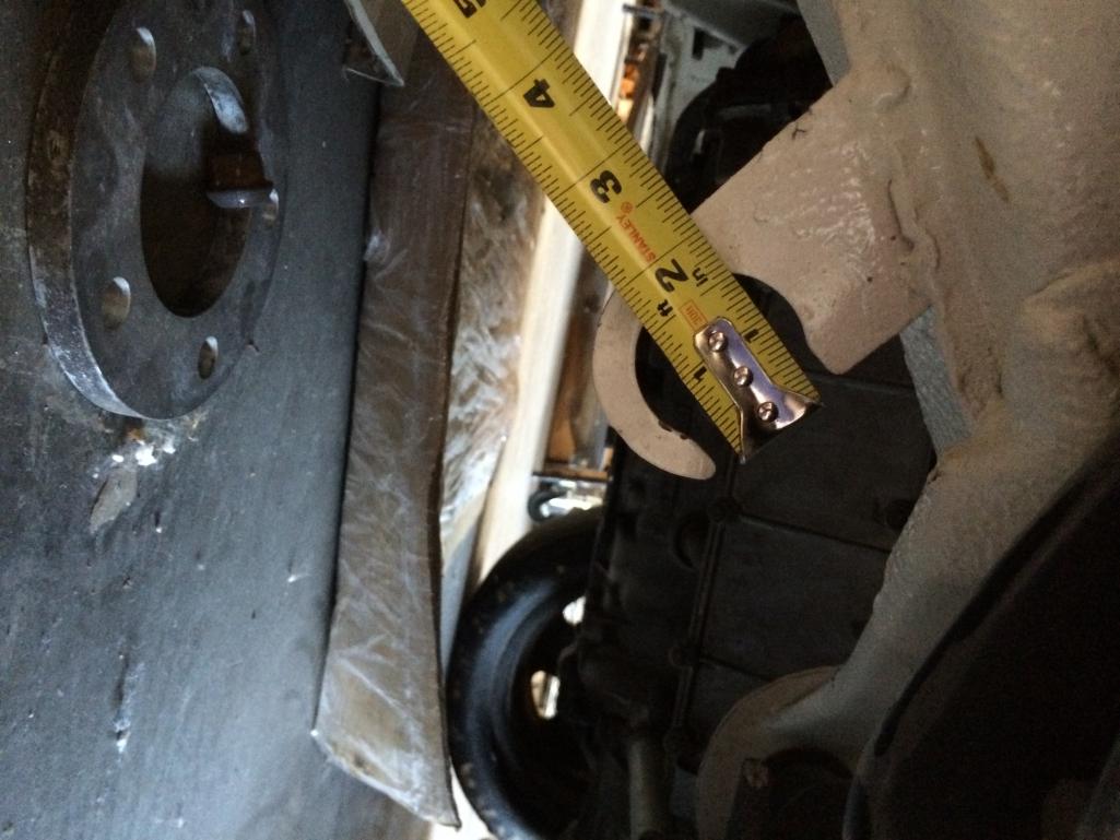

pencap914   Update: So I bought this car knowing the tub was ...   Mar 14 2021, 10:29 PM
mate914   Most all of the rear pillar strength comes from be...   Mar 15 2021, 07:27 AM
pencap914   Most all of the rear pillar strength comes from b...   Mar 15 2021, 10:15 AM

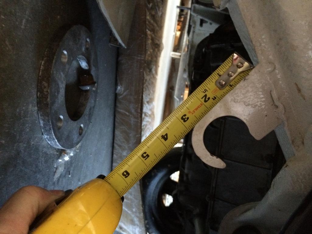

pencap914   Well before I weld on the motor mount for the 911 ...   May 23 2021, 03:35 PM
bkrantz   I fixed some lap joints the PO left on my car, inc...   May 23 2021, 08:36 PM
pencap914   I fixed some lap joints the PO left on my car, in...   May 24 2021, 07:01 PM
gereed75   Where possible, you might consider the “cut and ...   May 24 2021, 06:06 AM
pencap914   Where possible, you might consider the “cut and...   May 24 2021, 07:11 PM
nditiz1   I too have the same 3/8 gap at the bottom of my ma...   May 24 2021, 07:31 PM
