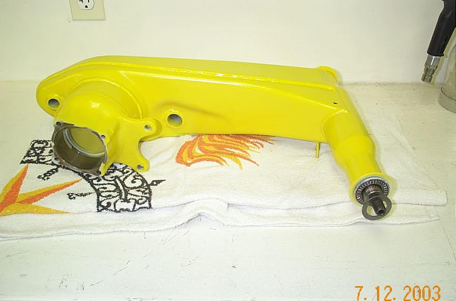

If you run sticky tires (as I assume Andrew does), rock chips are a major issue.
I just dug out rocks up to one inch on a side out of my rockers.
My formerly pretty swing arms are well blasted at the pivot area. The etch primer under the top coat is holding up well, tho. A before pic...
