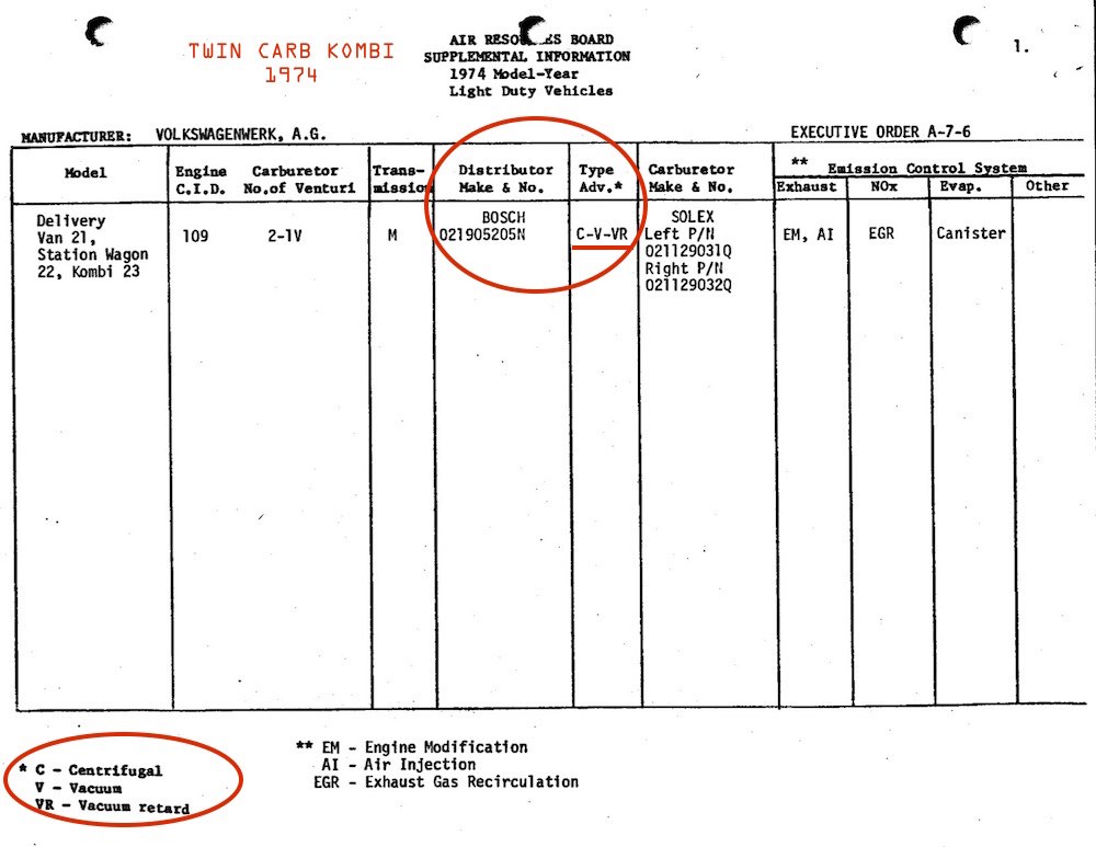

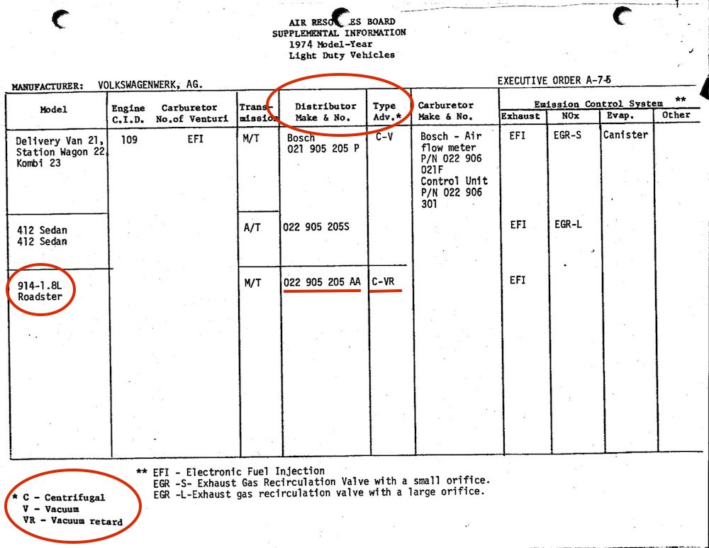

i cracked the Executive Order open a little bit more.
i found a specfication description for a retard and advance function distributor included in the Executive Order A-7-6 covering the 74 Kombi Van fitted with the dual carb version of the 1.8.
the dist is described as C-V-VR. = centrifugal + vacuum + vacuum retard.
compare it to the A-7-5 covering the EC-a engine 914 1.8.
the dist is described as C-VR = centrigugal + vacuum retard.
if they were talking about our cars with the EC-B sticker it would say C-V-VR.
our cars have the vacuum advance and vacuum retard.
(vacuum = vacuum advance function).
also our tune up sticker matches that dual functioning distributor hooked up.
in this E O they are talking about your cars (L-Jet 914).
the EC-A cars with only the distributor retard hooked up as supported by your original tune up sticker.
so the EC-A cars are approved in california from Jan 29th 1974 on for 3 months and a further 30 days and from March 25th on for 3 months and a further 30 days. which gets them to the end of production for 74 MY.
the EC-B cars are still missing in this documentation from CARB.
we know they conform to California and EPA. (or at least their sticker claims that).
i think it would be reasonable to conclude that EC-A cars kick in for sale in california after end of jan 74. (they might be making them in production a little earlier but they hit the showrooms for legit sale after that date).
which begs the question, what were porsche selling in their cali showrooms as a base model before jan 74 for MY 74. they must have had something to offer?
