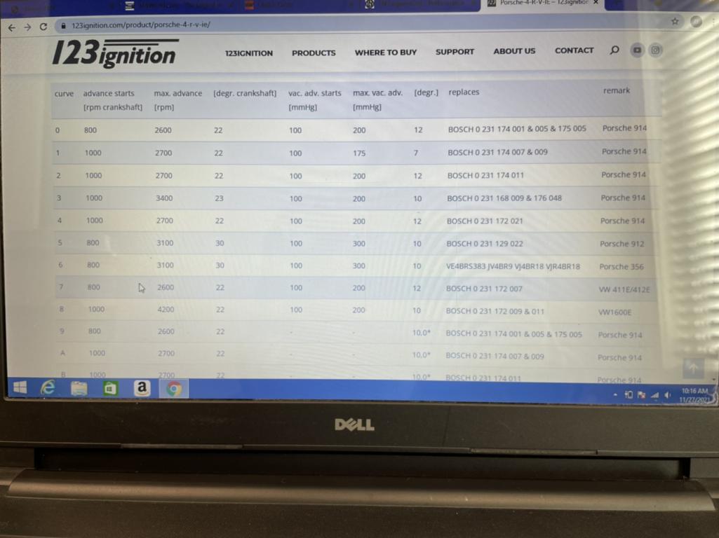

yea, i am concentrating on my afr readings during part and full load and it’s really close now, so if reading at idle is a bit rich that’s fine, as you say it may not be accurate, now i need to see why my idle is so low, or why i need that idle screw out that far. so will do a recheck on the vac like you suggested and check my advance at idle , then may reconsider the curve i’m using and as rob is saying maybe put the vac line back on and change the curve setting back to either 3 or 4. here is the chart from 123
