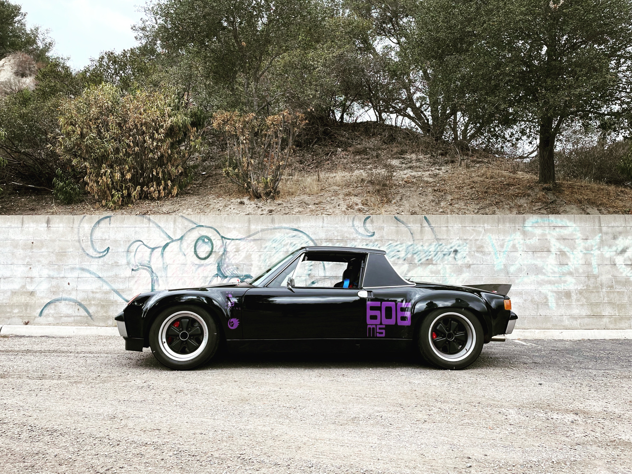

FG hoods and bumpers. Cage and super stiff suspension makes it track oriented, but it is “street legal” and I run it to work or to C&C.
