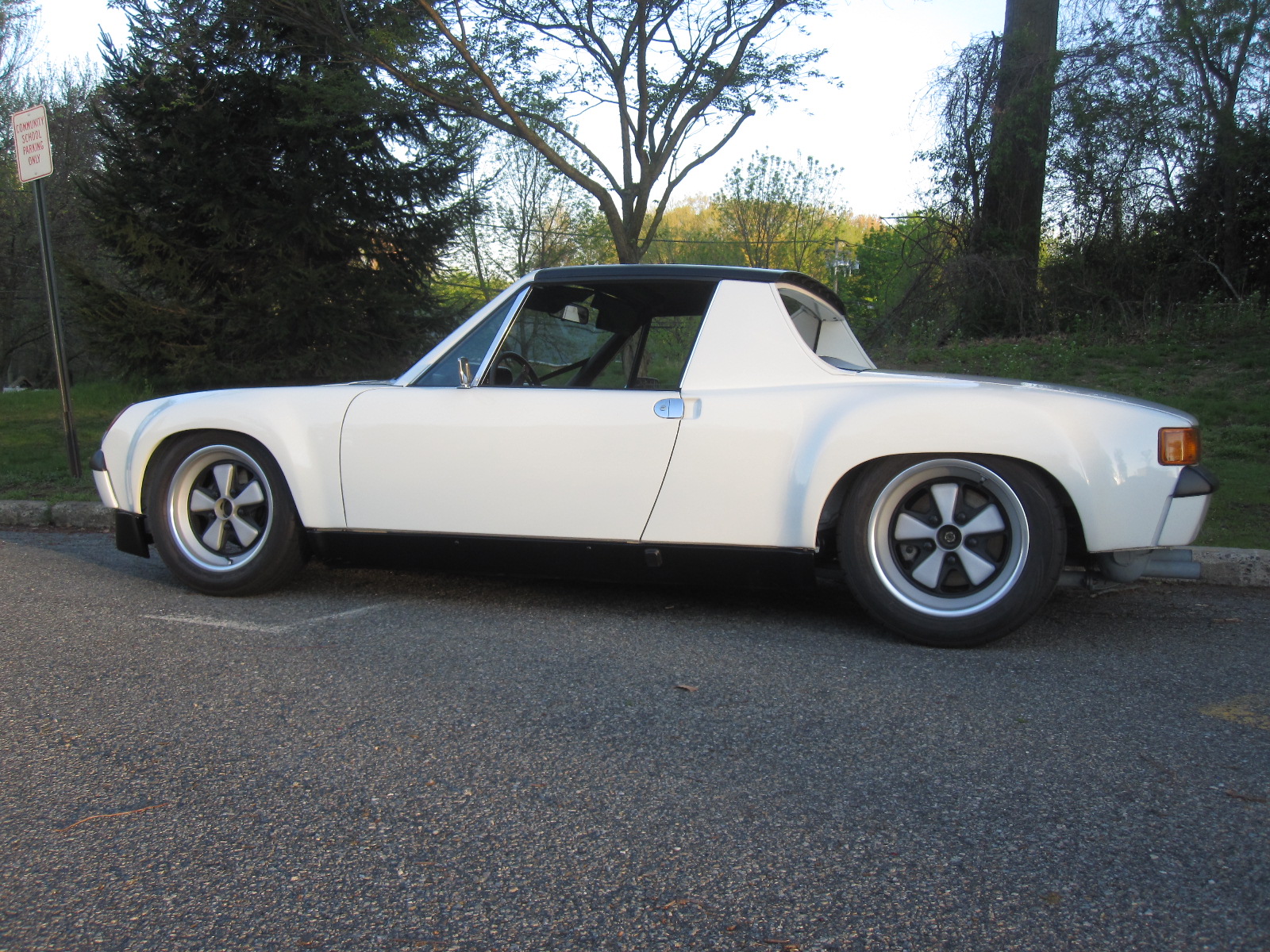

'75 chassis, aluminum 2.0 6 cyl. FG lids and bumpers. 2125 lbs.
Late doors with beams. Steel flares.
Soon to have ~250 hp 3.0 so 8.5 power to weight.
