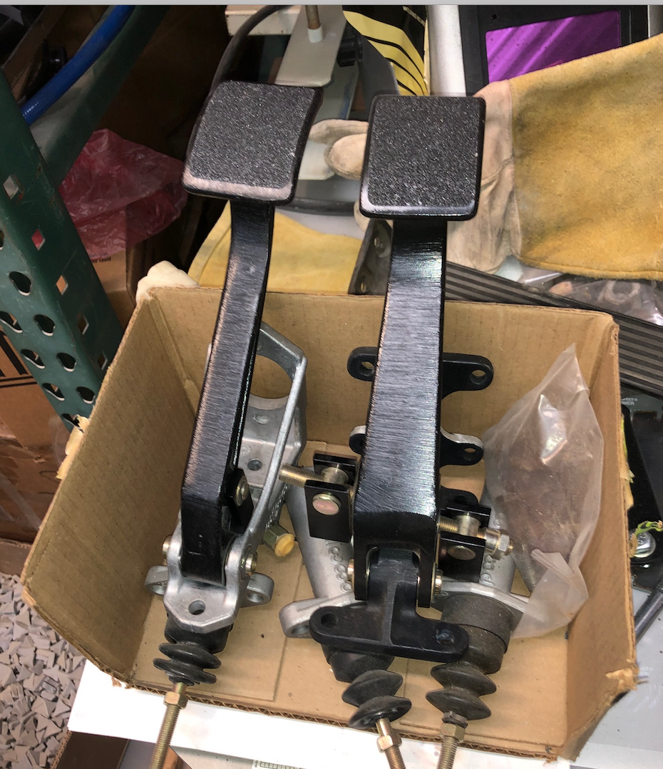

As the new car that I have coming to me does not have the master cylinder for the 930 box I called Easy wrecking and went over my options of putting a G-50 Clutch and brake assembly in. They have one for $250. but they think there will be a lot of work to modify it to fit and may not be the best bet. They said Tilton has some Hydraulic clutch set ups. I would like to know of some ideas that you guys may have for the setting up of the Hydraulic clutch on my 930 trans that has dropped some LSD.

Wilhelm, thanks for making me up this piece
Bob B Attached Image Attached Image

burton73   Wilhelm, thanks for making me up this piece Bob ...   Dec 17 2021, 02:59 PM
burton73   Bob B   Dec 17 2021, 03:04 PM
