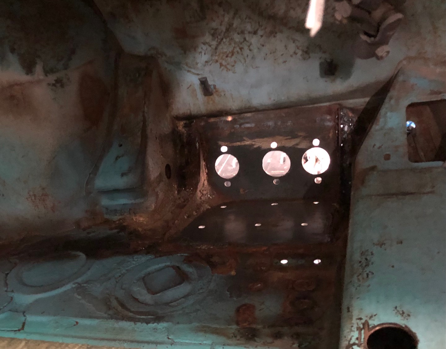

As the new car that I have coming to me does not have the master cylinder for the 930 box I called Easy wrecking and went over my options of putting a G-50 Clutch and brake assembly in. They have one for $250. but they think there will be a lot of work to modify it to fit and may not be the best bet. They said Tilton has some Hydraulic clutch set ups. I would like to know of some ideas that you guys may have for the setting up of the Hydraulic clutch on my 930 trans that has dropped some LSD.

wbergtho   I bought a Tilton MC (15/16") and installed i...   Nov 26 2008, 06:11 PM
byndbad914   I have the Tilton triple pedal assy - actually one...   Nov 26 2008, 06:30 PM
byndbad914   note this had a rod end and a super simple bracket...   Nov 26 2008, 06:33 PM
burton73   This is the factory floor set up for a G-50 from a...   Nov 26 2008, 06:43 PM
burton73   You where on this faster than me. Bob   Nov 26 2008, 06:49 PM
andys   I mounted a Wilwood clutch master using a bellcran...   Nov 26 2008, 06:55 PM
Larry Hubby   I mounted a stock 944 clutch master cylinder next ...   Nov 26 2008, 07:30 PM
burton73   You guys have given me some great ideas. Andy’...   Nov 26 2008, 09:41 PM
Larry Hubby   The yellow cap is just a plug on the input nipple ...   Nov 27 2008, 01:38 AM

Wilhelm   I derived a similar solution. This way I can work...   Nov 29 2008, 07:26 PM
burton73   I have decided to install a full late Carrera sus...   Nov 30 2008, 12:25 PM
burton73   Wilhelm, I find the Clutch pedal Wilwood 340-1289...   Nov 30 2008, 01:25 PM
burton73   I have found the Wilwood Part Number: 340-1285 ...   Nov 30 2008, 04:16 PM
Wilhelm   That would be the correct double cylinder pedal pa...   Nov 30 2008, 05:44 PM
burton73   If you look closely the throttle pedal has a label...   Nov 30 2008, 07:16 PM
Wilhelm   I am using this pedal because I am using this engi...   Nov 30 2008, 07:30 PM
burton73   That is gorgeous. :wub:   Nov 30 2008, 08:15 PM
burton73   Wilhelm, thanks for making me up this piece Bob ...   Dec 17 2021, 02:59 PM
