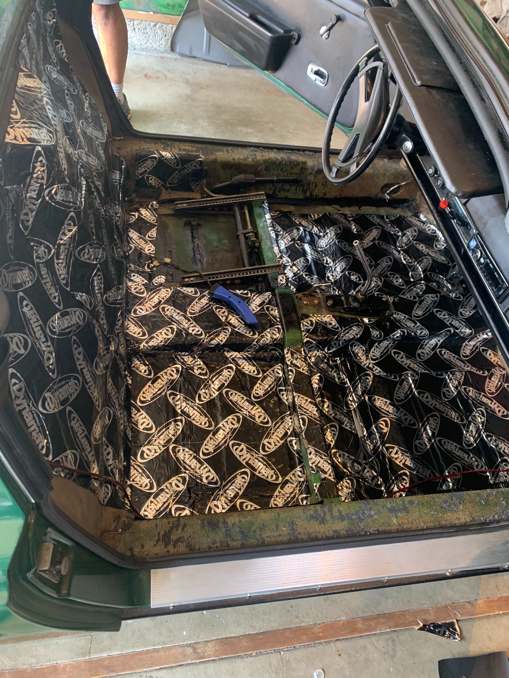

The installed carpet was well worn, and I wanted to check the firewall, footwells, and floors for rust when I first got the car, so I stripped the interior and installed (Maybe too much) dynamat and new carpet while I was in there.

Dynamat Installed
