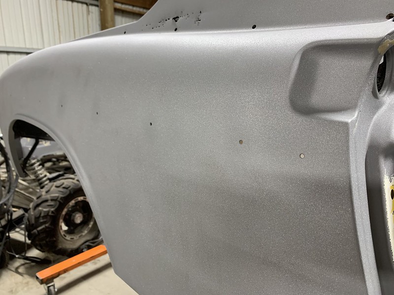

One surprise was finding what I assume are trim holes along the sides (plugged with filler). Was there an option for trim pieces down the fenders on 914s? I've never seen a 914 with trim.
(IMG:http://www.914world.com/bbs2/uploads_offsite/live.staticflickr.com-22225-1642614524.1.jpg)

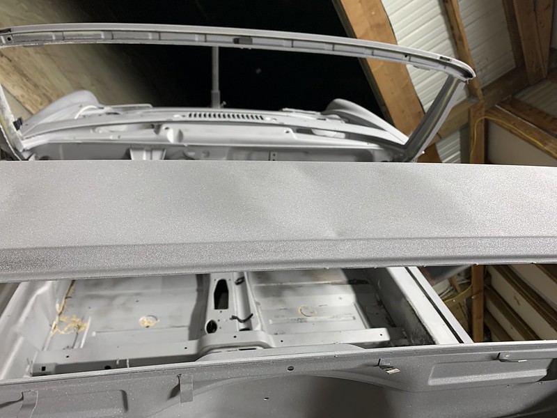

Also, this is a total headscratcher. How the hell does this happen?
(IMG:http://www.914world.com/bbs2/uploads_offsite/live.staticflickr.com-22225-1642614524.2.jpg)

QUOTE(pploco @ Jan 19 2022, 12:48 PM) *
The roll bar damage is caused by a careless drop of the roof when installing or
someone standing on the flat surface.
I'm surprised it's not seen more often.
The roof can be a struggle for a small person.

mepstein   The side trim was an aftermarket thing. Barbaric ...   Jan 19 2022, 12:35 PM
VaccaRabite   Beltine trim was a dealer option. Ruins the lines...   Jan 19 2022, 02:27 PM
76-914   I'm glad to see you back on it. Centering your...   Jan 19 2022, 10:26 PM
mgarrison   FWIW, my Targa bar had all kinds of dings & de...   Jan 20 2022, 07:52 AM
mepstein   When I worked at the Porsche shop, we had a Ferrar...   Jan 20 2022, 09:40 AM
