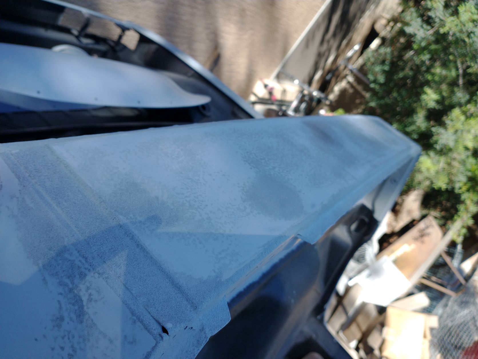

FWIW, my Targa bar had all kinds of dings & dents in it. One rather large on the driver's side. Mine had never been filled until I took the effort to do it. All the dark areas are lower/dents... (IMG:style_emoticons/default/confused24.gif)
