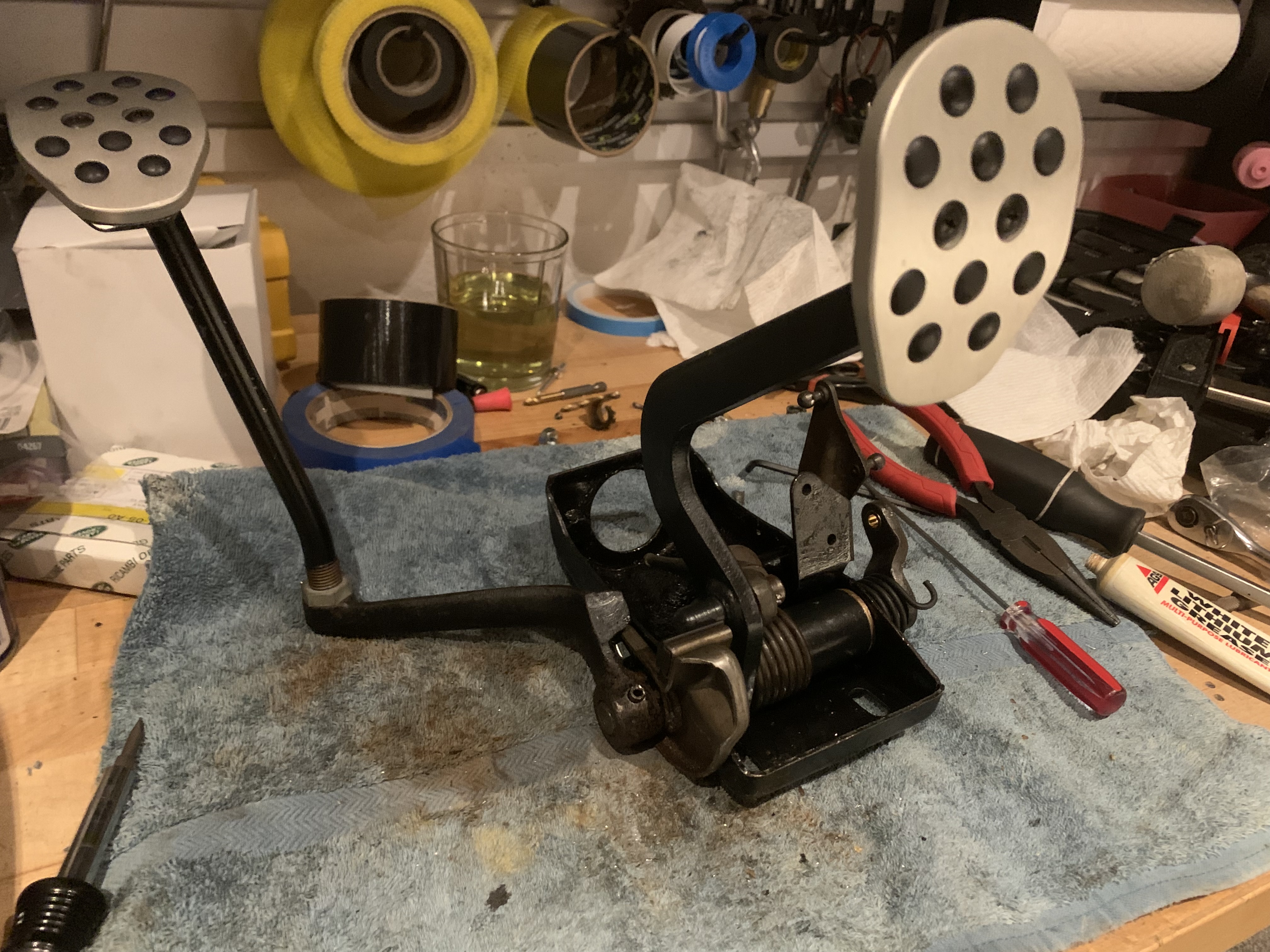

After noticing the amount of play in my accelerator pedal, along with the annoying squeak every time I engaged the clutch, immediately went here to research solutions.
Found out pretty fast the nylon bushings disintegrate, and looked into my pedal cluster and saw a nylon graveyard. Bronze bushings were then ordered from Pelican.

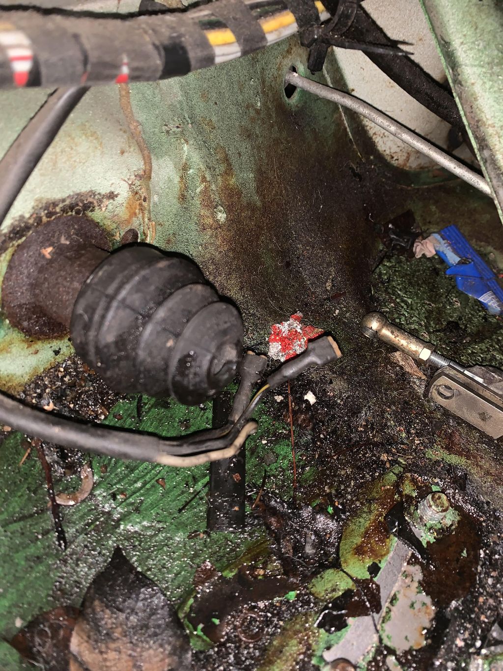

Yesterday I removed the pedal cluster from the car and saw what a mess it was underneath. What I did not see was rust! (IMG:style_emoticons/default/biggrin.gif)
After removing the cluster

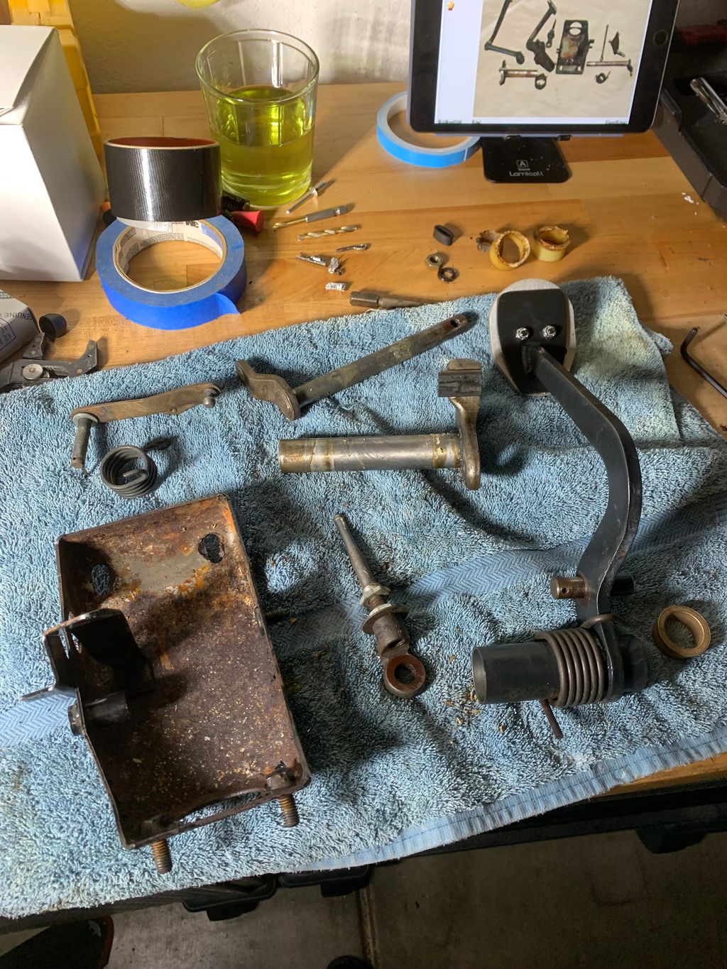

The cluster fully disassembled, after following Eric Shea's excellent write-up on rebuilding the pedal cluster. Ended up carefully drilling out the old roll pin holding the pedals to the base, because the hammer was not persuasive enough. Eventually got things free and I had a new pin anyways so no harm done.
Sanded and painted the base, gave everything a good clean, then went about replacing all of the what used to be nylon bushing with the new bronze ones. Everything got a healthy coat of silicone grease before going in.
Pretty happy with the result! Looks much better, and while you cant see it after the pedalboard and carpet are in, you sure can feel the difference. Each pedal feels miles smoother than before, and the play in the accelerator cable is all but gone.
