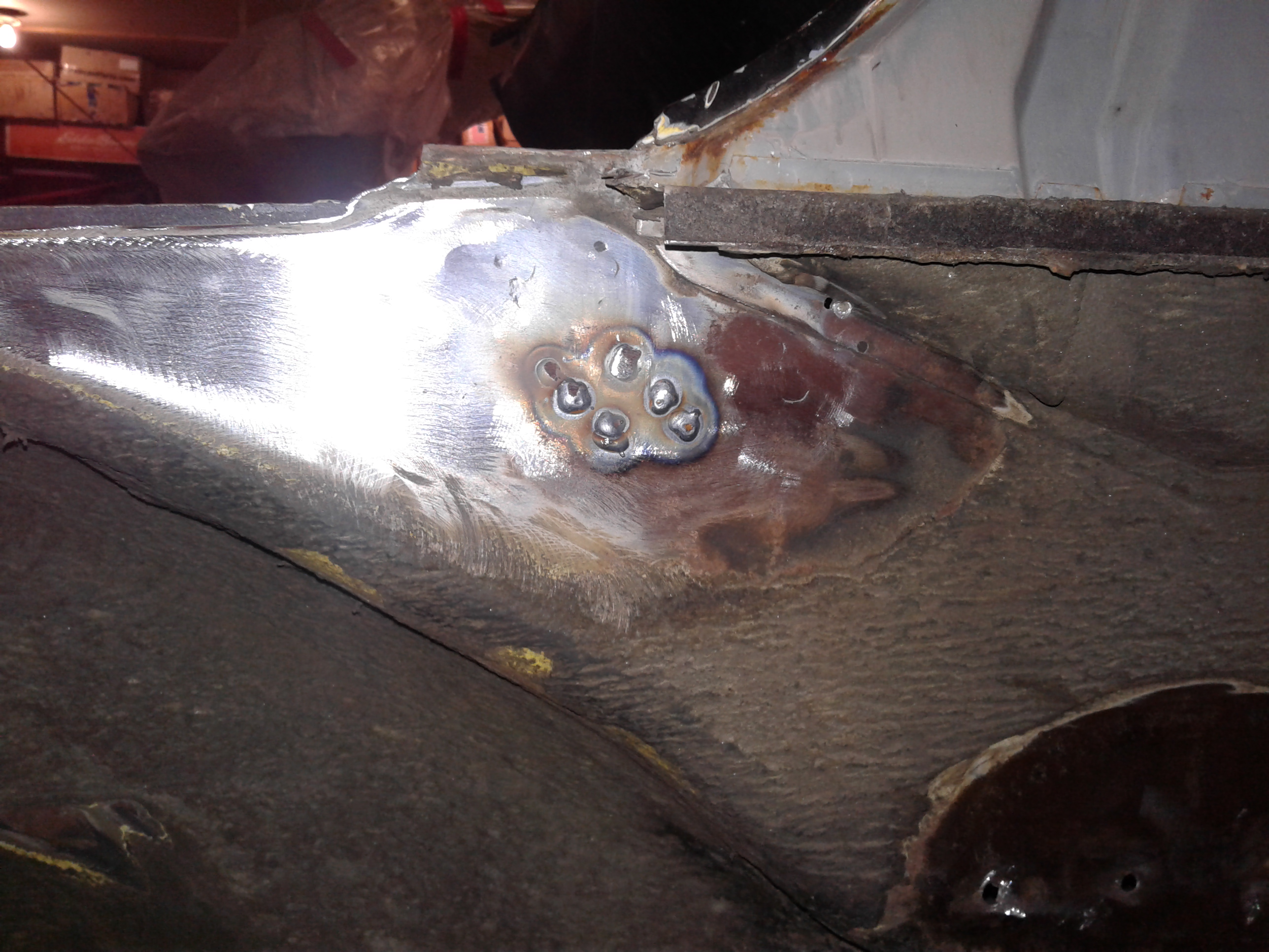

Upon delivery I discovered there were areas where rust had staked it's claim. The sail panels had, as I now know, the usual rust; the battery tray and the area immediately behind it plus a small area on top of the long beneath; and finally a few spots along the front rain channel.
To say I was distraught would be an understatement. Thirteen years and 2 more 914's later I know it was a good deal. Did I mention I paid $1600 for it delivered. The longs were solid as was the rest of the car. I removed the wiring mess for the car alarm & CB radio then reconnected all the wires to their original terminals. Next I replaced the Fuel Pump relay, added gas. After a turn of the key it coughed, farted and started. That's pretty much the Reader's Digest version but little more was done than that.
I hadn't worked on any cars since I was a teen and none of those needed rust repair. However, after building an airplane years earlier, I had some experience with aluminum and fiberglass. Do you see where this is going?
I thought it time that I go back and do a proper repair job on the old girl. Don't get me wrong. I thought that the aluminum angle patch pieces on the rain channel, the fiberglass in the Hell Hole and Bondo on the sail panels was "good enough"! Looking back, I didn't know Shit from Apple Butter.
It has remained as such but Since both of my Subaru conversions are basically finished, sans a paint job on the '73, I decided to go back and correct my "Get're done" repairs. I bought the rail repair pieces from 914rubber which in turn gave me an excuse to buy a metal shrinker/stretcher.

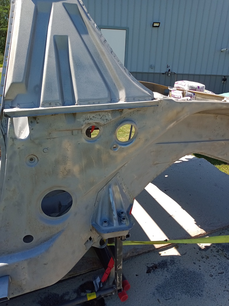

It is not attached. The factory used a butyl type caulk rope seal. I thought I had a better photo buy you can see a flat vertical surface the rope stuck to and a small lip sticking out pointing at the panel.
Found a better photo

rick 918-S   It is not attached. The factory used a butyl type ...   Jan 31 2022, 06:44 AM
76-914   Perfect Rick. Thank you very much. I know what I n...   Jan 31 2022, 10:51 AM

Chris H.   Nice work Kent! Don't see any distortion ...   Feb 4 2022, 08:24 AM
76-914   Thx Chris but there is a little shrinkage at the w...   Feb 5 2022, 06:46 PM
