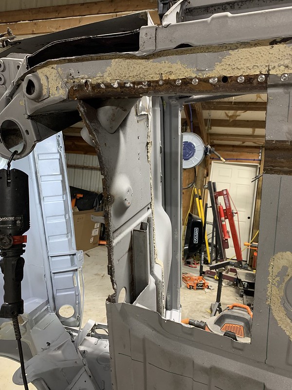

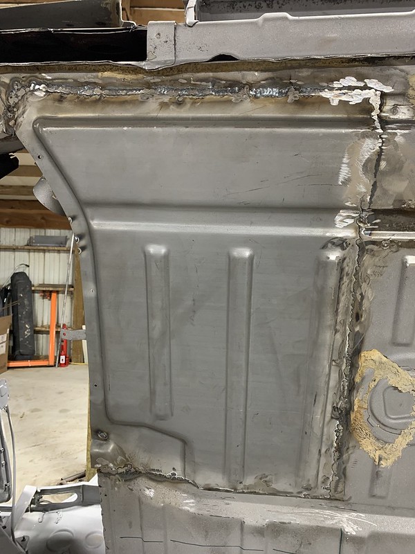

I've been picking away at the rust repair. This is definitely a "slow and steady wins the race" type of effort. It's been super cold in Boise, so I'm not able to do any priming as I go. With that in mind, I've been working on the areas that are open so I can prime once things warm up. Feels like a bit of a puzzle.
The passenger floor plan was swiss cheese.
(IMG:http://www.914world.com/bbs2/uploads_offsite/live.staticflickr.com-22225-1643649191.1.jpg)
The seat hinge mount looked to be in good shape. I'll clean it up and reuse it.
(IMG:http://www.914world.com/bbs2/uploads_offsite/live.staticflickr.com-22225-1643649192.2.jpg)

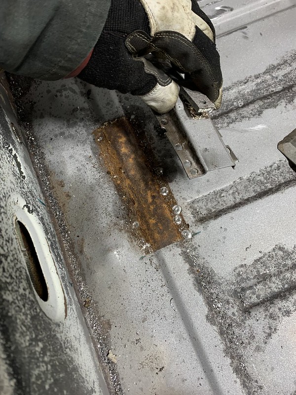

The floor pan has lots of spot welds. After drilling out about 10 of them, I realized that I didn't need to save the old pan section. Out came the grinder.
(IMG:http://www.914world.com/bbs2/uploads_offsite/live.staticflickr.com-22225-1643649192.3.jpg)
(IMG:http://www.914world.com/bbs2/uploads_offsite/live.staticflickr.com-22225-1643649192.4.jpg)

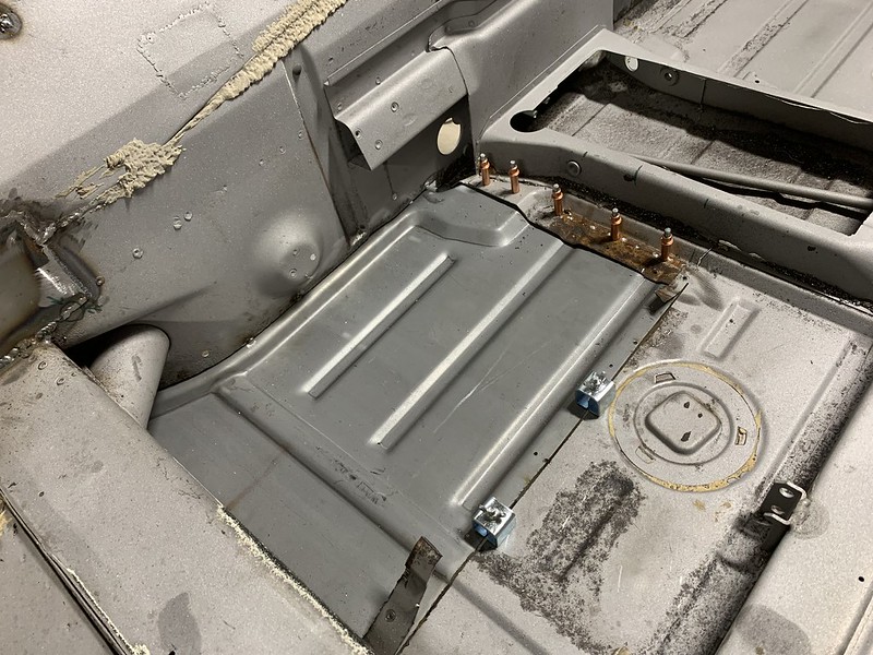

now I have to fix a small section on the drivers side just under the inner firewall, and fix a couple small sections of the outer firewall. Overall the metal under the tunnel is good, there are a couple of small pinhole areas that I think I can fill. I'm debating if I should open the tunnel up. I really want to clean things up and pull the old tubing out.

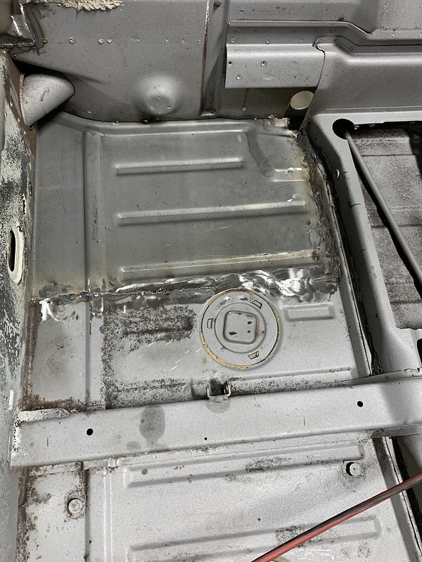

I cut the old section out leaving about 2 inches overlap. I lined up the new section and used clecos to hold it in place. I then cut through both layers. As I went, I'd pull the cleco, peel back the old metal, and add a butt clamp. Once it was flush, I tacked it in place.
(IMG:http://www.914world.com/bbs2/uploads_offsite/live.staticflickr.com-22225-1643649192.5.jpg)
Still need to do a bit more clean up, but it turned out pretty nice. Keeping the heat down with a copper backing and small stitch welds was definitely the way to go.
(IMG:http://www.914world.com/bbs2/uploads_offsite/live.staticflickr.com-22225-1643649192.6.jpg)
(IMG:http://www.914world.com/bbs2/uploads_offsite/live.staticflickr.com-22225-1643649192.7.jpg)
