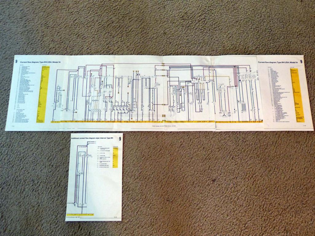

Another question: where can I find the best wiring diagram? My Haynes is very difficult to follow, especially with having to keep turning pages. I have a nice diagram from Prosperos but it is missing quite a few details. If we could only scan what Jeff has in the 914 section of his brain!

QUOTE(robkammer @ Feb 3 2022, 12:40 PM) *
Rob
Here's what I did Rob. Downloaded scans and printed each page, then taped together so it's continuous. Makes it easier to trace connections.
Dan

QUOTE(lesorubcheek @ Feb 3 2022, 03:08 PM) *
Rob
Dan
Thanks Dan: I did the same things a few months ago. I was staring at it again today and still find it useless. I look like Sherlock Holmes with my magnifying glass trying to find a clue, like where is the light by the heater lever in the console? We're lucky Jeff is good natured and will help if asked.
It seems that my car has been hacked by several over the decades, lots of black tape and poorly crimped splices. I'm just trying to make everything work as it should, like most others. Stay healthy!

vitamin914   [quote name='robkammer' post='2979238' date='Feb ...   Feb 8 2022, 07:58 AM
lesorubcheek   Dan, Do you have a link where to download that w...   Feb 8 2022, 10:00 AM
vitamin914   Dan, Do you have a link where to download that ...   Feb 8 2022, 12:33 PM
lesorubcheek   Beautiful and thank you! That factory elect...   Feb 8 2022, 01:06 PM
