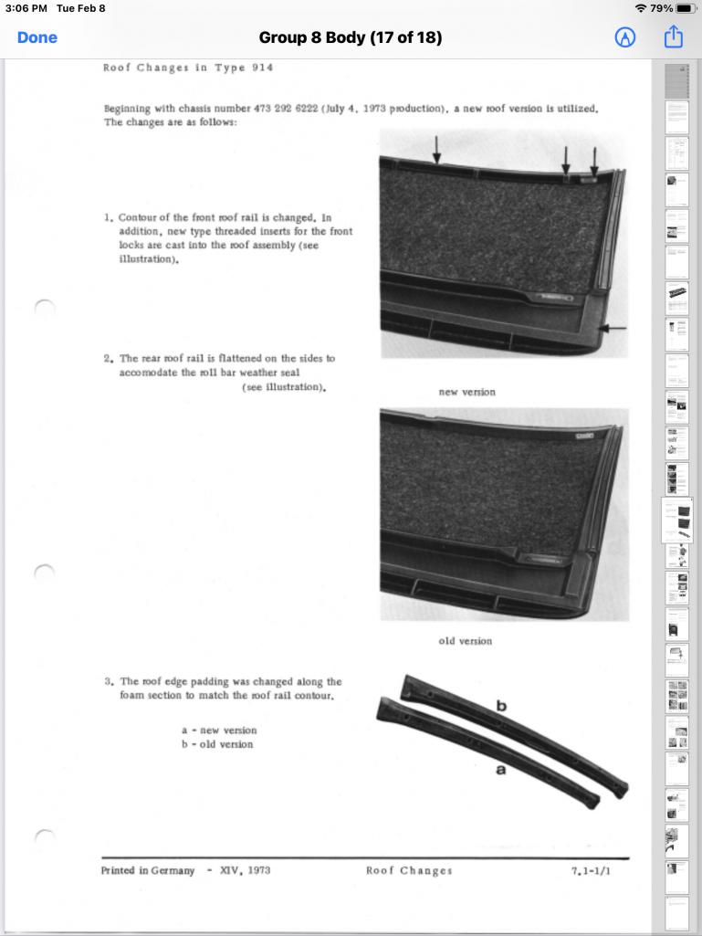

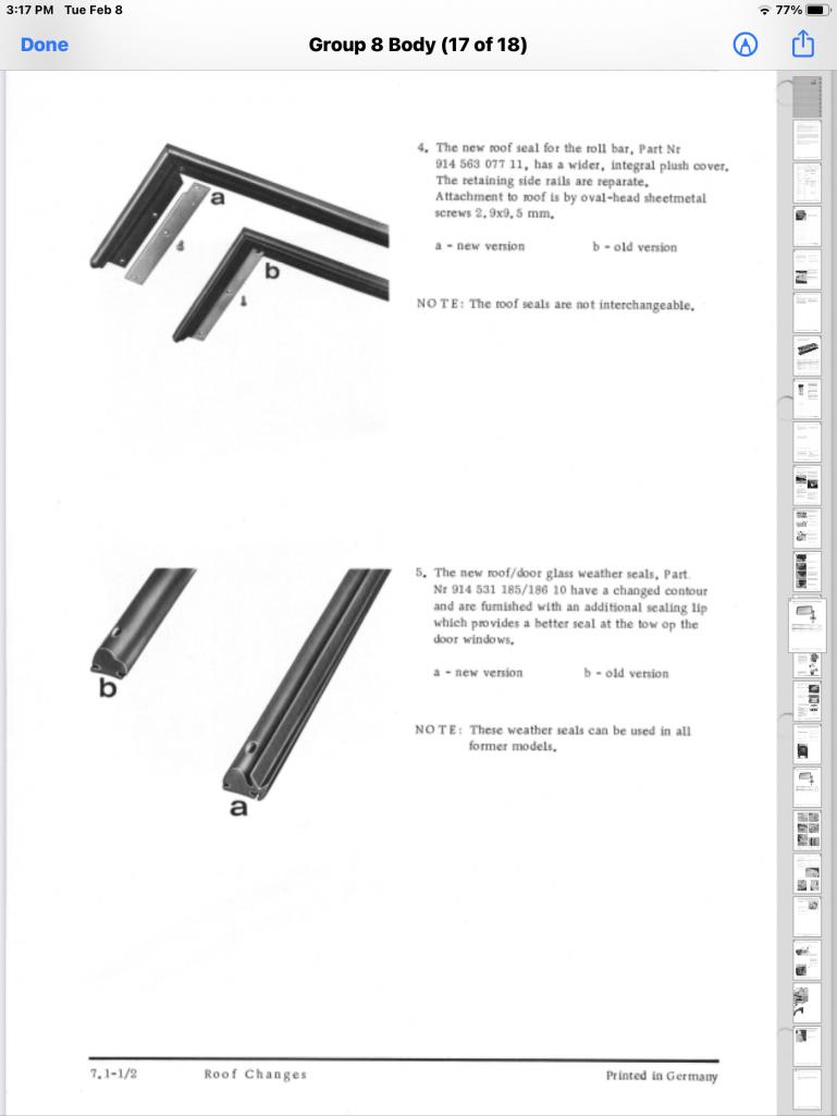

The official word from the factory manual.
