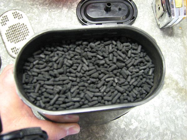

Van B   Well, I pried open my canister today. And as suspe...   Feb 8 2022, 01:47 PM
wonkipop   thanks for the look inside. so what you are sayin...   Feb 8 2022, 03:39 PM
JeffBowlsby   Your pellets are too small.   Feb 8 2022, 03:51 PM
lesorubcheek   Your pellets are too small. That's what she ...   Feb 8 2022, 05:13 PM
Van B   No. Those pellets, as you see them, are too small....   Feb 8 2022, 04:00 PM
wonkipop   No. Those pellets, as you see them, are too small...   Feb 8 2022, 04:07 PM
wonkipop   good thing he opened it up then. someone must hav...   Feb 8 2022, 04:00 PM
Van B   good thing he opened it up then. someone must ha...   Feb 8 2022, 04:14 PM
