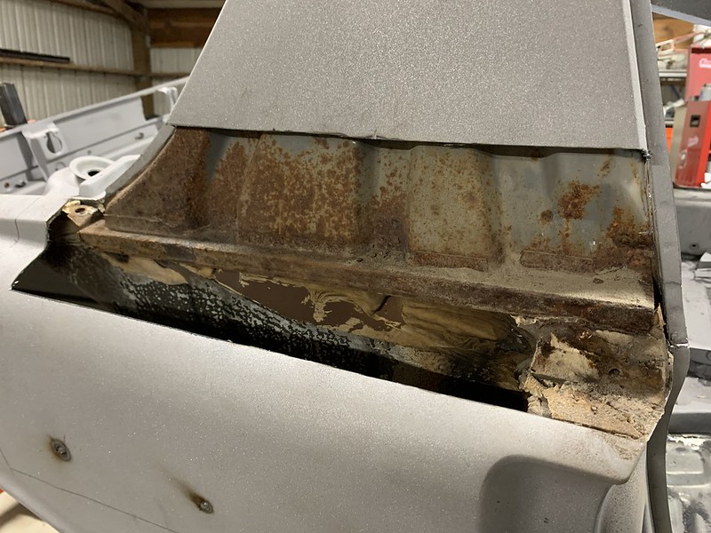

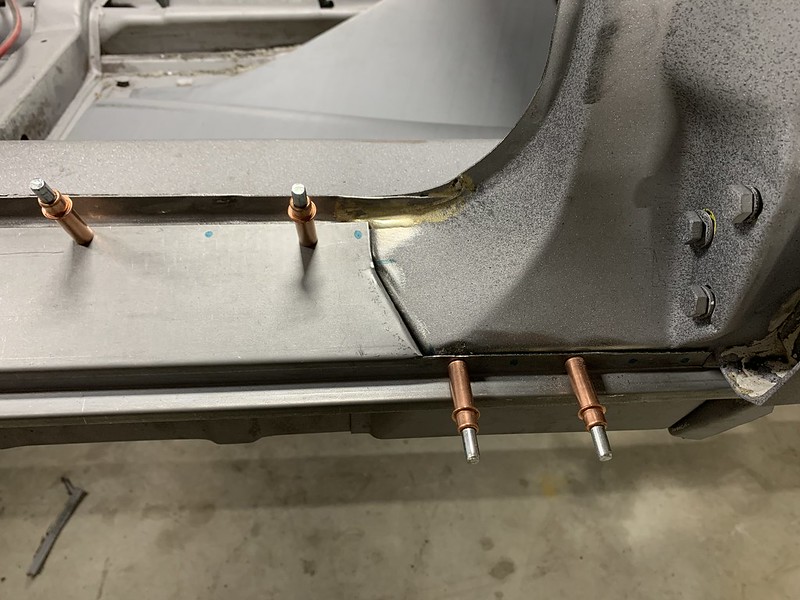

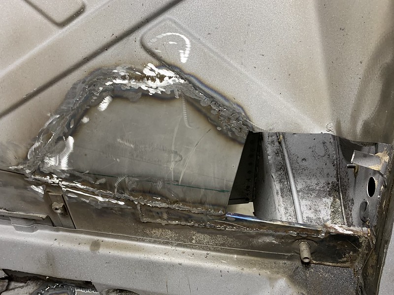

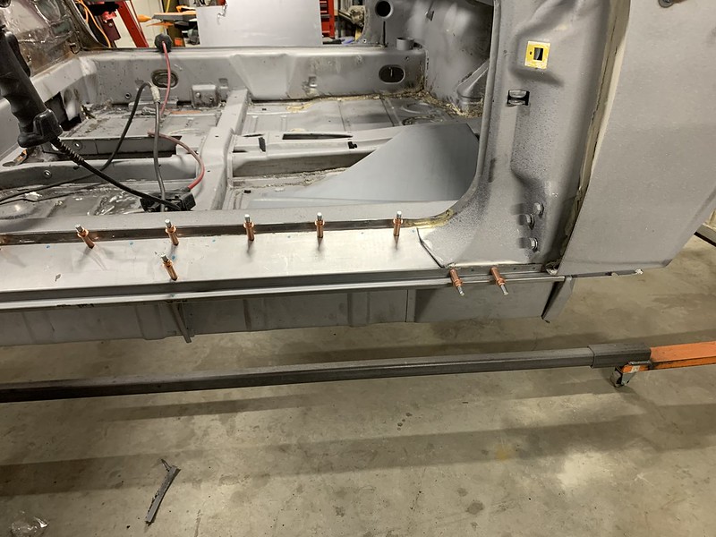

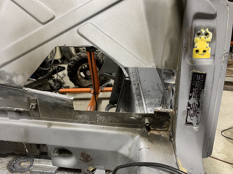

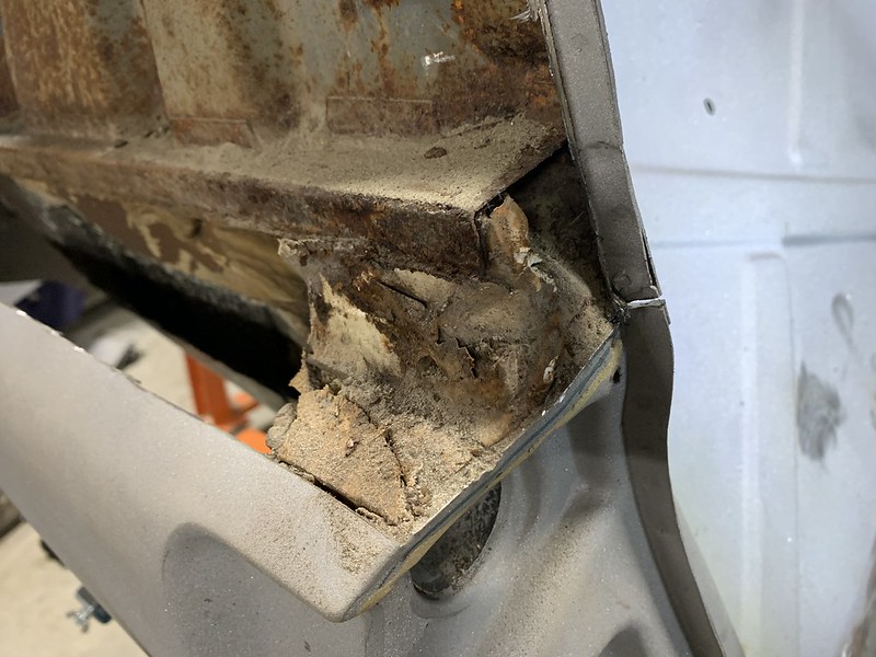

I've been making steady progress on the rust repair. I finished up all the outer firewall patches, and decided to replace the passenger door sill. I debated on it, because it wasn't terrible, just pitted in several spots where the rockers attach. I decided to just pull it - I'm glad I did. Besides shaping the front, it wasn't bad and I was able to clean up the rust underneath. It's still too cold to shoot primer, so I've got it mocked in with Clecos for now; I'll pull it all apart to spray once things get a bit warmer.
(IMG:http://www.914world.com/bbs2/uploads_offsite/live.staticflickr.com-22225-1645201384.1.jpg)
(IMG:http://www.914world.com/bbs2/uploads_offsite/live.staticflickr.com-22225-1645201384.2.jpg)
(IMG:http://www.914world.com/bbs2/uploads_offsite/live.staticflickr.com-22225-1645201384.3.jpg)
(IMG:http://www.914world.com/bbs2/uploads_offsite/live.staticflickr.com-22225-1645201384.4.jpg)

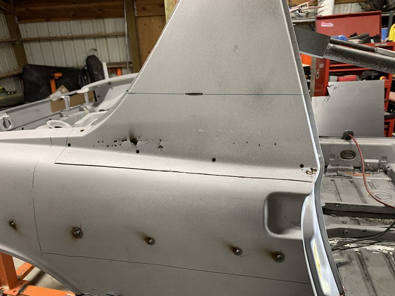

I decided to tackle the passenger sail. Partly so I could open up the top of the quarter panel and dig out the seam sealer. What a mess. Fritz got slap happy with the seam sealer gun - I had to dig a brick of that shit out of the space between the door jamb and the sail panel.
I'm sure there was a good reason for it, but why would a big chunk of sealer be sprayed up inside the panel. Is it for sound deadening, or to keep rigidity? Either way the stuff sucks!
I'm pretty conservative when I do cuts like these, but it looks like I'm going to have to pull the sail panel all the way to the top of the targa bar to clean up all the rust.
I'm definitely tainted now when it comes to rust in these cars. Whenever I see an ad for a 914 that says "little to no rust" I vomit a little in my mouth.
