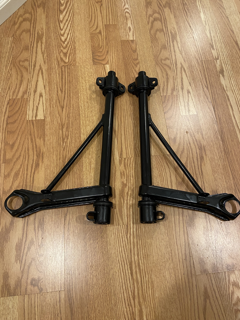

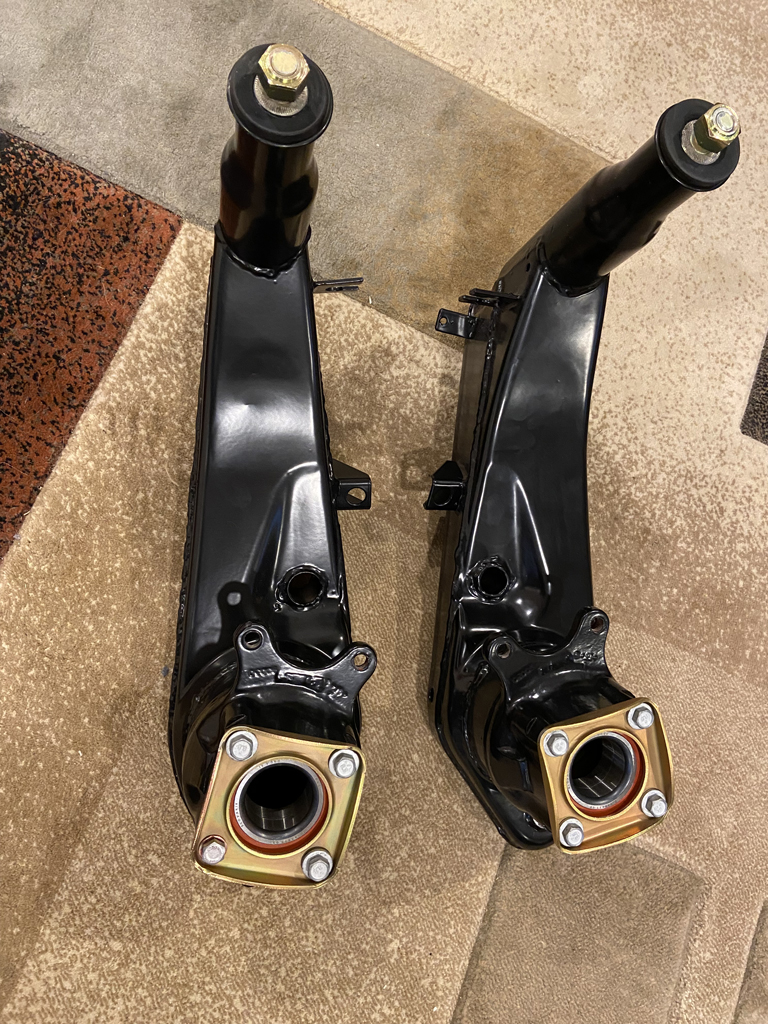

Given that you've done a full tub acid dip, are you heading toward powder coating?
Here's a couple pics of powder coat.
Rear Semi Trailing Arms with re-plated hardware
Front Lower Control Arms
I screwed up and should have plated the front LCA rear bushing holders instead of powder coating them. The powder coat ends up affecting fit into the front crossmember negatively. Would also look nicer with that piece plated (IMG:style_emoticons/default/smile.gif)
Elephant racing has a nice video up of the front LCA bushing install and what angles to set the front bushing holders at to align perfectly with the body to avoid bushing preload.

Wow. That looks great. I'm jealous. I plan on powdercoating all of the big parts. I have the Harbor Freight kit and an old smoker for heating. I also have been practicing zinc plating and have the yellow chromate solution. I will post pictures as I make progress.
Interesting idea to plate the bushing inserts.
