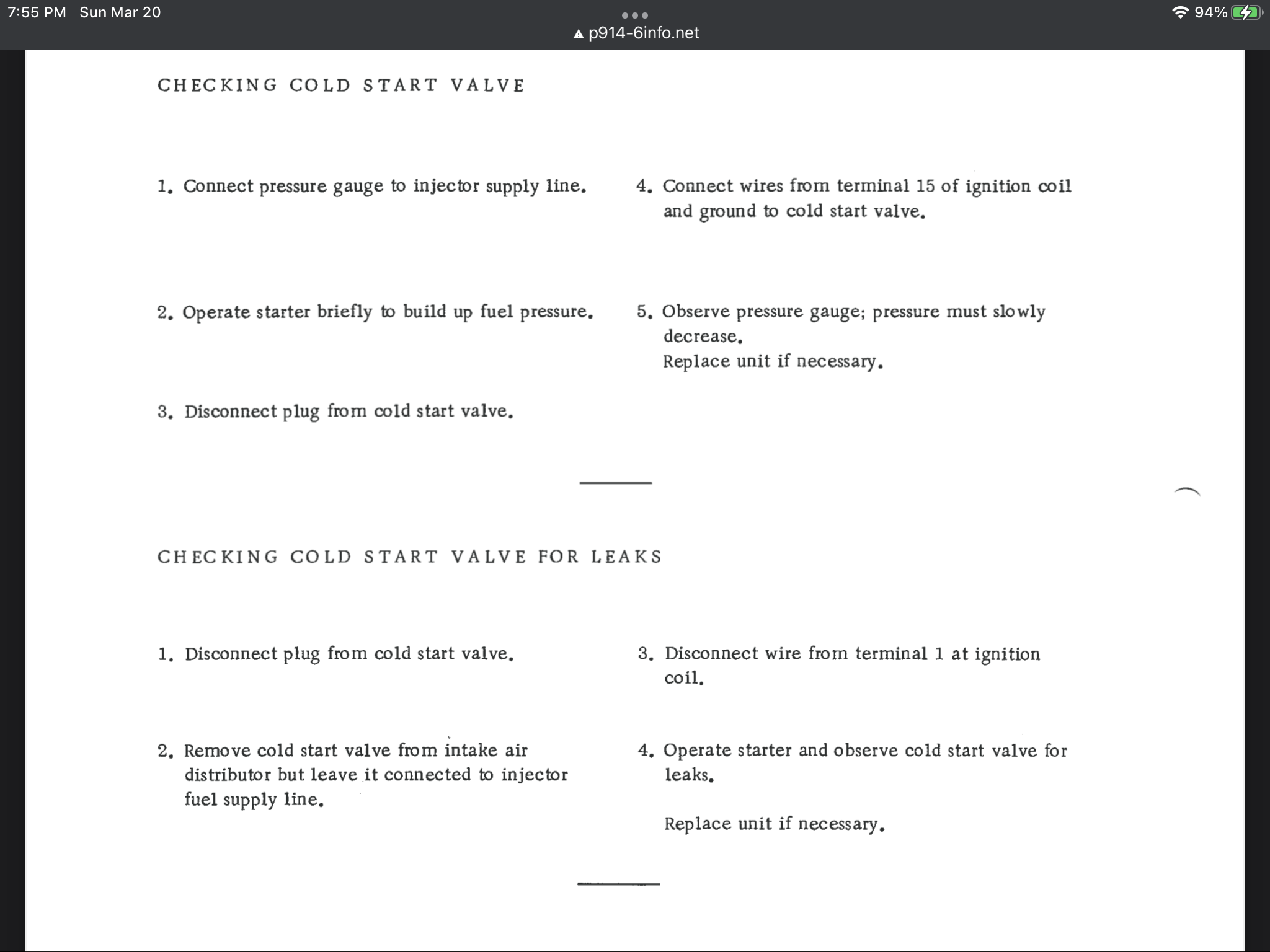

I like the idea of adding some gas, wonder if you could send 12v to the csv without hurting anything.

Says you can, but it’s not real helpful…. I don’t know which prong on the CSV should get positive and which should get ground.
