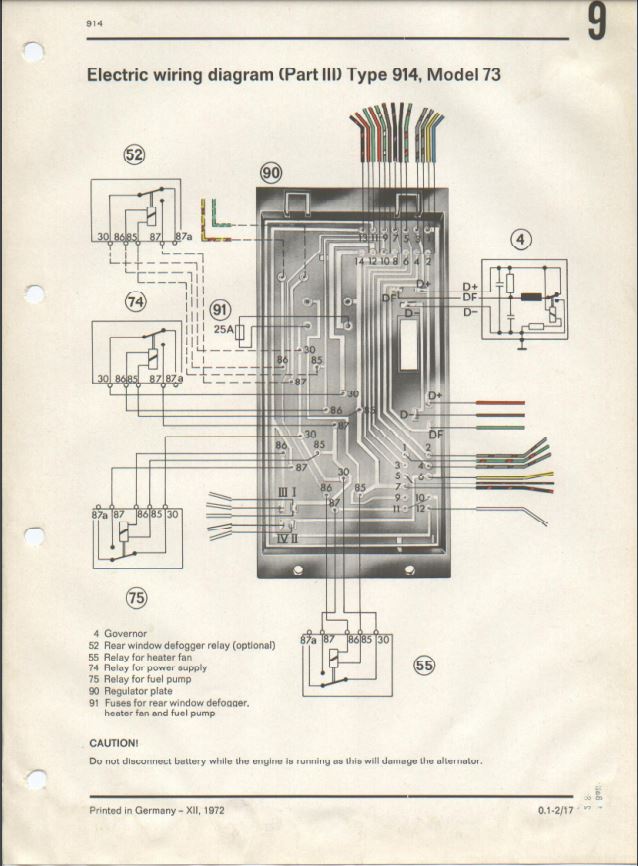

Not clear what you're indicating here. Is the fuel pump is hot wired to the black/red wire that feeds the coil + (pin 7 of the 12 pin engine harness connector?). Why would this "patch" have been done? Maybe I'm misunderstanding your description of "patch" or your description of "aft" which I assumed to mean rear of the car.
If so . . .
I'm going to go way out on a limb. (IMG:style_emoticons/default/sad.gif) Fuel pump in-rush current may be stealing some voltage from the coil preventing a nice hot spark when you first start cranking. Once fuel pump motor in-rush current reaches steady state, voltage to coil pops back up and now you get a hot spark. I'm so far out on the limb that it's about to break but the bottom line remains the fuel pump should be fed off it's own circuit and not shared with the coil.
Fuel pump feed (which is also black / red to further confuse things) should be fed by 12v coming off Pin 13 of the 14 way connector at the front of the relay board that runs perpendicular to the voltage regulator.
I'm also going to note that if you start disconnecting and reconnecting either the 12 pin or the 14 pin connectors -- BEWARE-- they can be installed while shifted 1 pin. The 1970's era error proofing of a plastic guide pin on one end is basically a defective design and can't prevent the connector from being improperly installed in a shifted condition.
Shifting the 12 pin connector WILL result in a shorted coil negative wire that melts the wire insulation.

@Superhawk996
The answer as far as I can tell is yes, and I don't know. I don't know what the Black/red wire does, or why they spliced there when the fuel pump was relocated. The reason I mentioned it is that I was afraid it was probably robbing current from what should be getting power from that line... the limb you climbed out on is the one I'm already sitting on lol! Welcome!
I want to find the original wires for the fuel pump in the OE location but no luck so far. I'm hoping they weren't cut back and are just tucked away somewhere.
Thanks for the warning about incorrect fitment of the plug, but no reason for concern there. I try to avoid doing things that are simultaneously dumb, dangerous, and different.
It looks like the search for the original fuel pump wire is something I can pursue now as opposed to a new fuel pump and lines to deal with the pressure drop.

Superhawk996   Adding this relay board picture you might apprecia...   Mar 21 2022, 08:43 AM
Van B   yeah and it's a long wire running nearly the l...   Mar 21 2022, 08:44 AM
Van B   Looking at this, it seems whoever redid the fuel p...   Mar 21 2022, 08:48 AM

Van B   Well, I found the actual fuel pump wires... Uncove...   Mar 21 2022, 06:26 PM
wonkipop   Well, I found the actual fuel pump wires... Uncov...   Mar 21 2022, 08:02 PM
