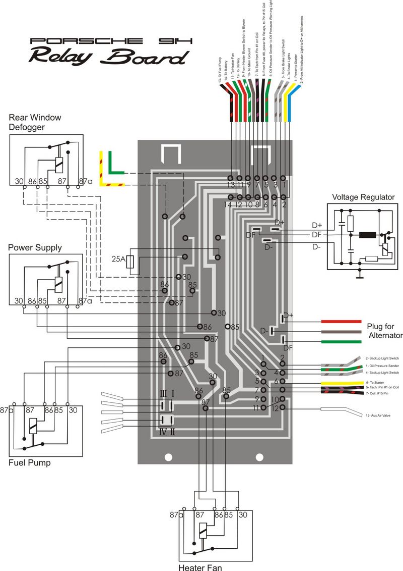

Adding this relay board picture you might appreciate. Not sure who created it . . . nice addition of circuit names.

Superhawk996   Adding this relay board picture you might apprecia...   Mar 21 2022, 08:43 AM
Van B   yeah and it's a long wire running nearly the l...   Mar 21 2022, 08:44 AM
Van B   Looking at this, it seems whoever redid the fuel p...   Mar 21 2022, 08:48 AM
