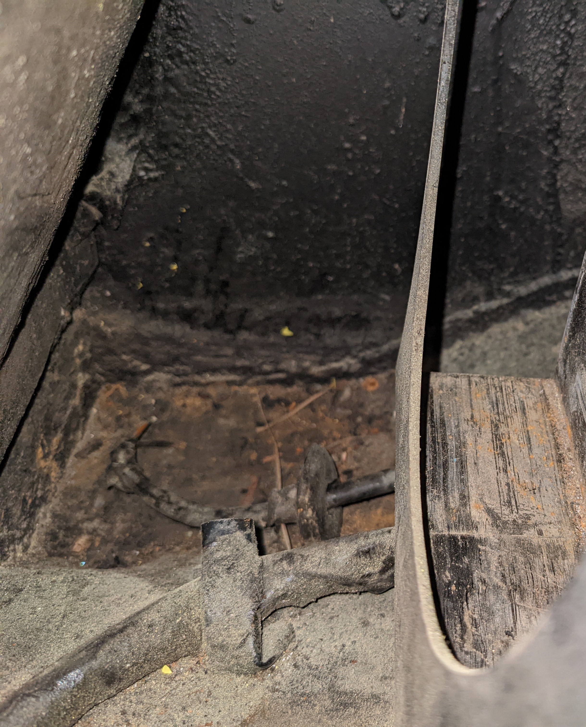

Well, I found the actual fuel pump wires... Uncovered and laying on the rubberized coating in the hell hole... M F'ing PO! He should've paid me for saving this car from his dumb ass!
Also, I verified that the CSV hasn't broken on me so, that's good. Although, I'm not happy with what I'm seeing with the Nissan TTS. After putting it in the freezer, I only get a lil' puff while cranking. And when it's warm, I get nada. I want that sucker to spray like aqua net while I'm turning over.
Any way, now that I've dug the wires out, it's time to get things hooked up properly.
