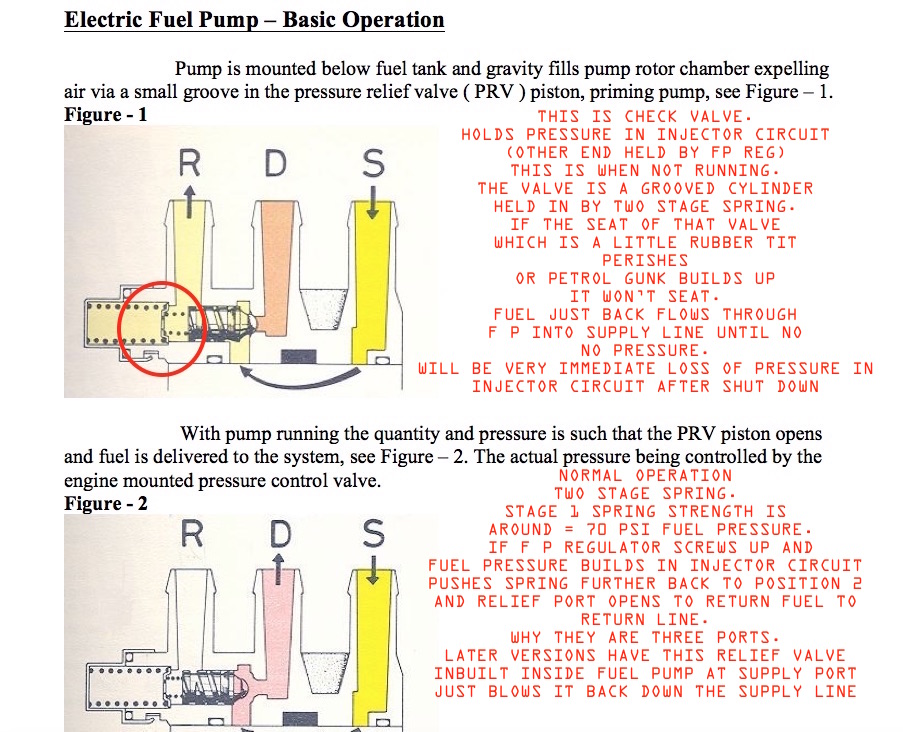

summary version of why 3 port pump might be losing the pressure.
send me your 3 port and you will never get it back.
(evil laughter).
postscript.
everyone thinks of their injector circuit hoses having to be able to take 35 psi.
but in fact they have to take 70 psi if fp reg stuffs up before the fuel pump will jump in and save it. so......keep those lines in real good condition.
