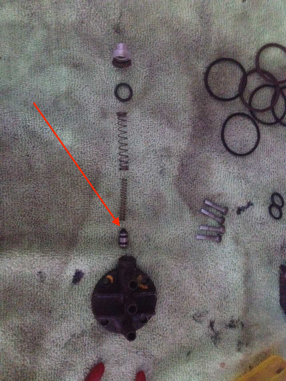

wonkipop
post Mar 23 2022, 10:27 PM
Posts: 5,480
Joined: 6-May 20
From: north antarctica
Member No.: 24,231
found the photo.
its a tit thing.
if thats perished or thrown in the towel after 50 years your pump is farked.
won't hold pressure. and where you get one i do not know.
if you are lucky just the recess it seals against is gunked.
or as i discovered the free operation of the valve sliding is compromised by gunk in the bore it moves back and forth in.
one of the pumps i did was very troublesome getting that valve to operate freely again.
i ended up wrapping fine grit sand paper around a wooden kebab skewer and giving it a hone.
in the photo i have it orientated the wrong way in the spread out layout.
for anyone smart enough to work that out.
you have to be half mad to rebuild one of these things.
but i am getting in practice for the coming dark ages.
