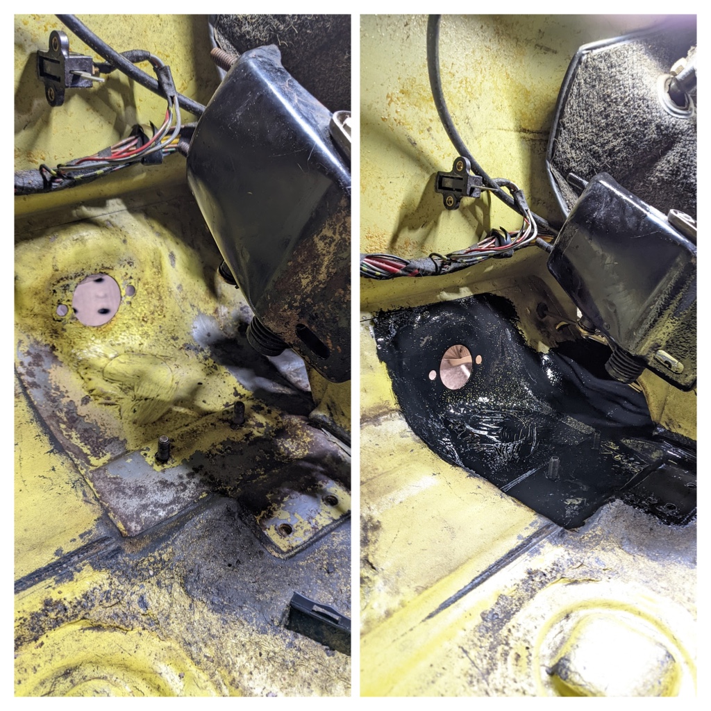

So, now that I’ve concluded that drama, I’ll be installing the master cylinder I bought from @billh1963 well ahead of my anticipated timeline.
Interestingly, my car came with a 19mm master cylinder as OE. At least there’s no indication that it was ever replaced from what I can tell.
