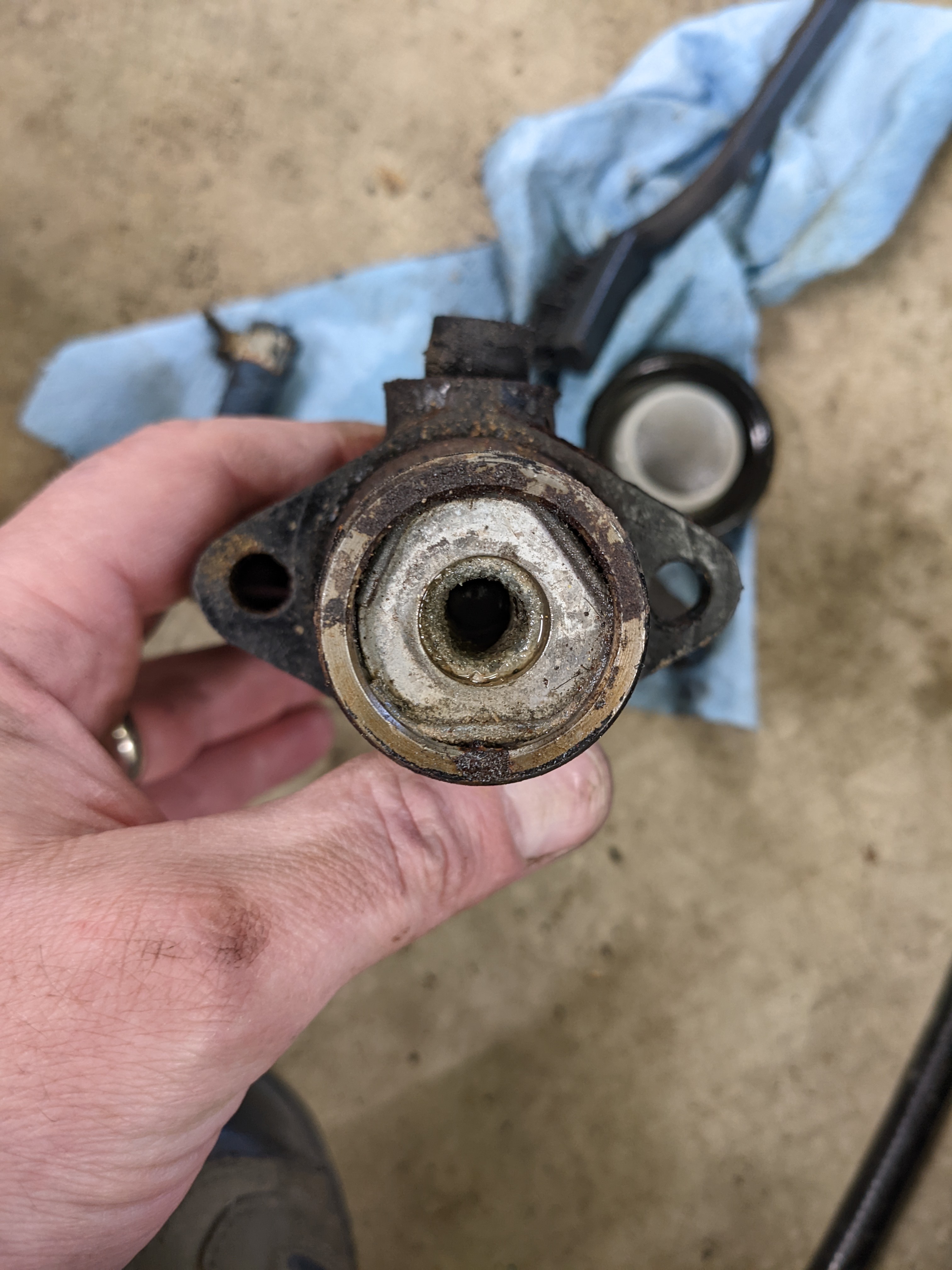

emerygt350   So seals on the rod. The seals on top for the rese...   Mar 26 2022, 05:36 PM
Van B   I’ve been eyeballing the motive pressure bleeder...   Mar 26 2022, 06:06 PM

Van B   Evening everyone! Master cylinder unplanned p...   Mar 27 2022, 07:31 PM
