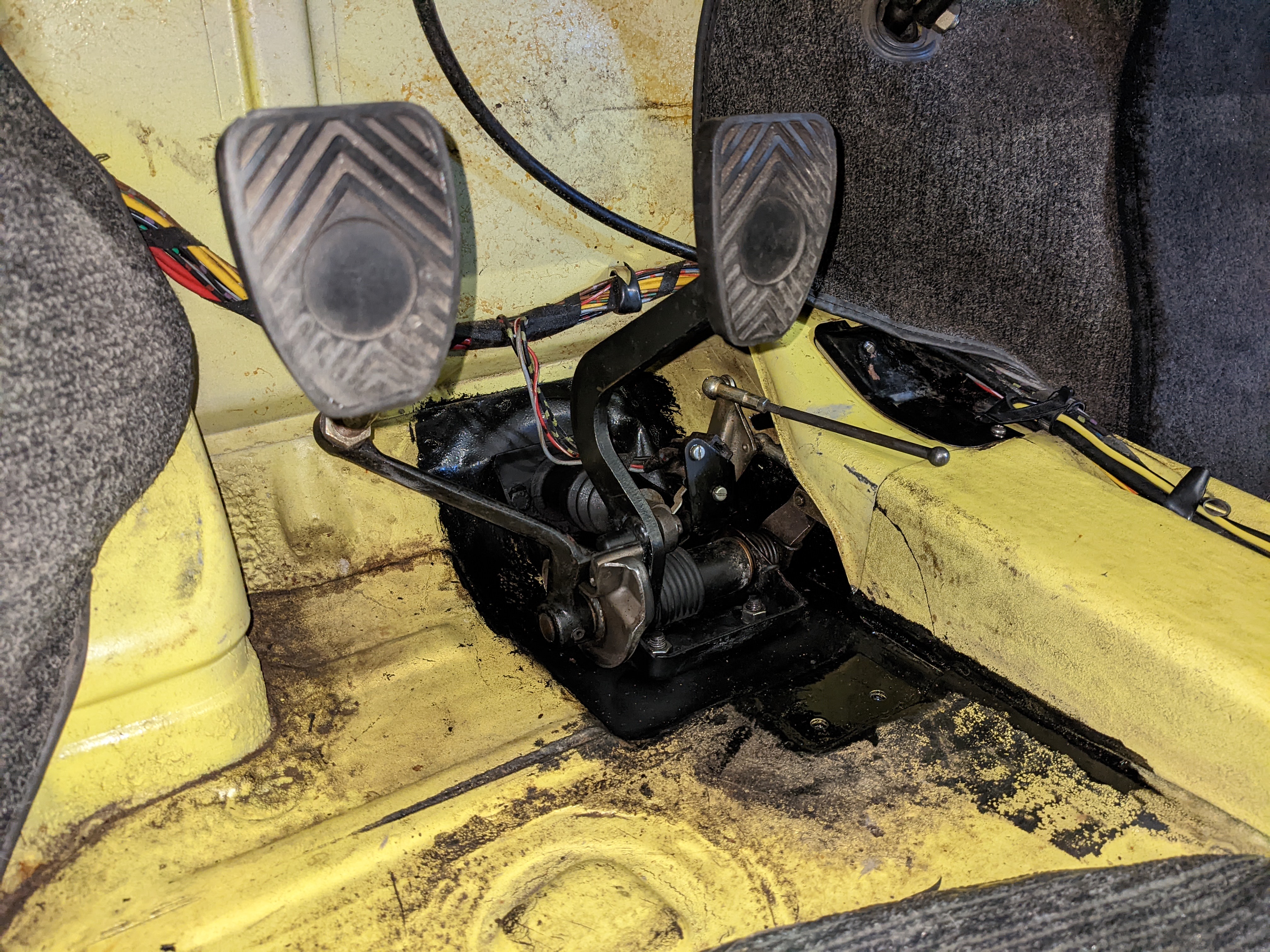

Master cylinder unplanned project is ready for fluid refill. I’m decently satisfied with the repairs.
You can see on the far right That I got the two wires ran for the fuel pump too… black and yellow, of course (IMG:style_emoticons/default/yellow914.JPG)
