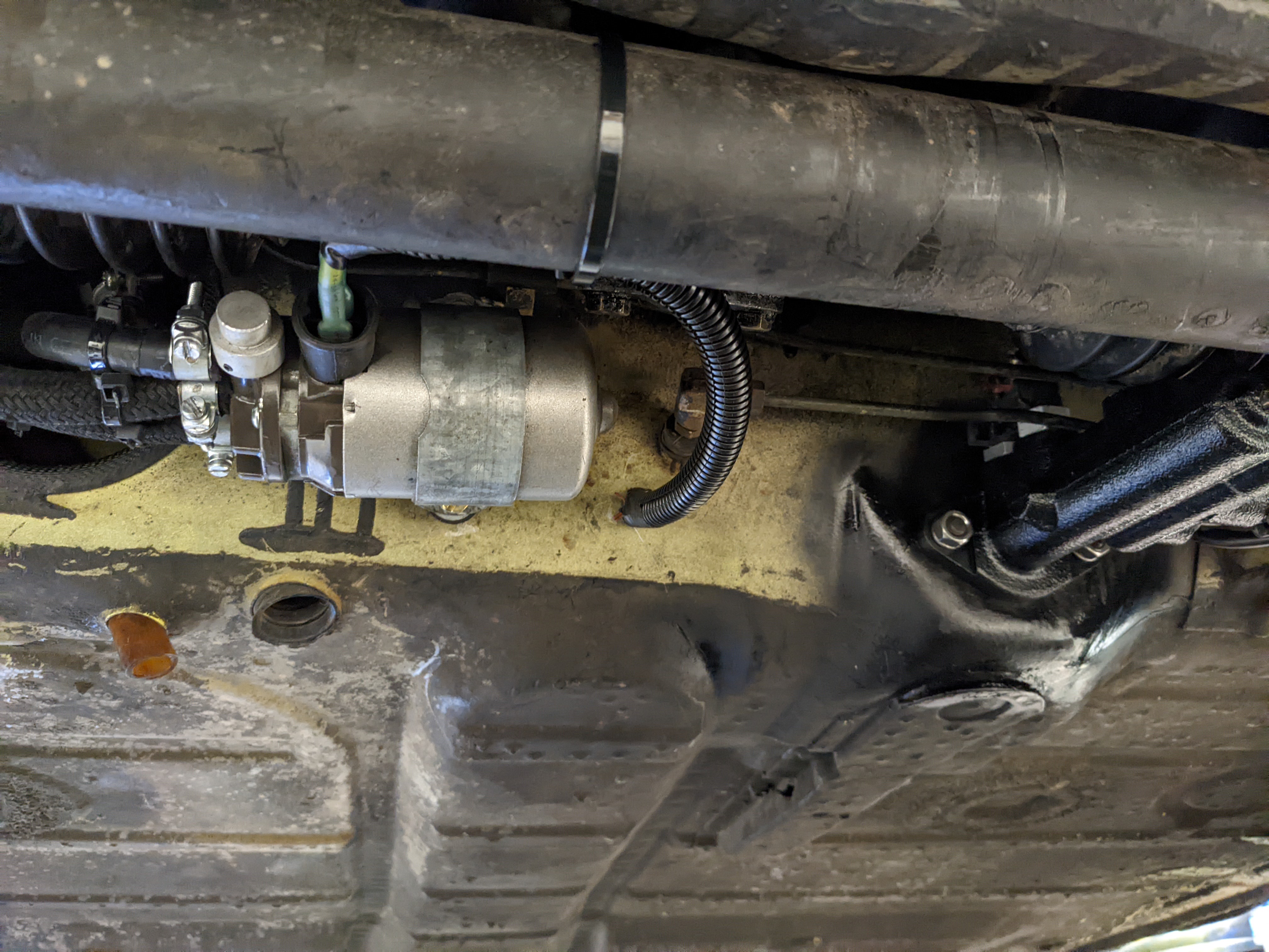

And finally, I’m back on the original task. Got the wires run, tidied up, and hack job splice into the coil wire re-soldered and restored.
Front end:
wonkipop
post Mar 28 2022, 04:14 PM
Posts: 5,480
Joined: 6-May 20
From: north antarctica
Member No.: 24,231
QUOTE(Van B @ Mar 27 2022, 07:37 PM) *
Front end:
that fuel pump is nice and shiny. looks like a rebuilt one.
if it was rebuilt properly that little pressure check valve in it ought to have been working well and not causing you to lose fuel pressure so fast after shut off.
hmmm.
the cap on the end of the port assembly is definitely not the factory style cap.
its a cap you sometimes see on the remanufactured ones. so they have been in there and redone/cleaned the interior of the valve assembly.
