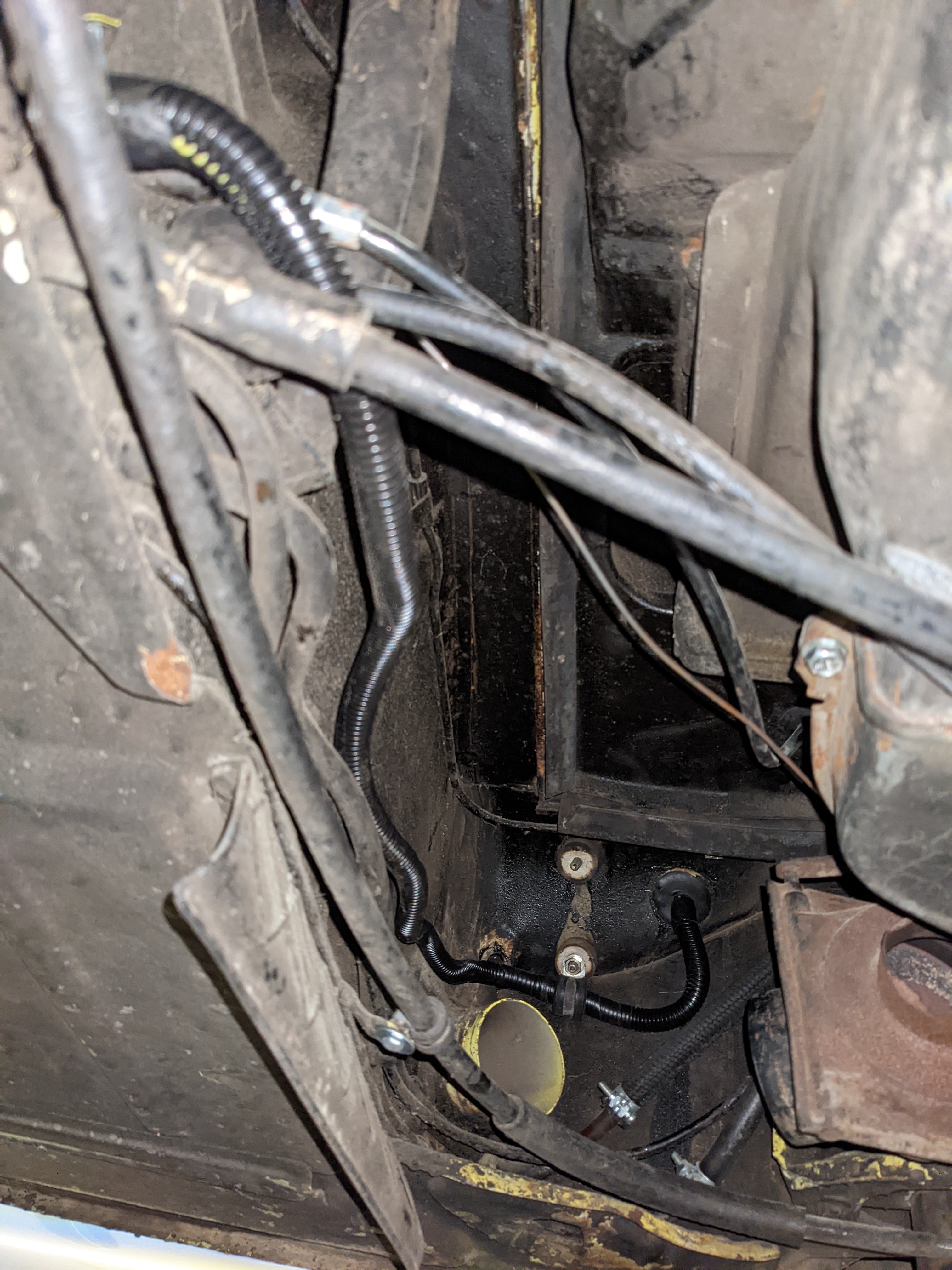

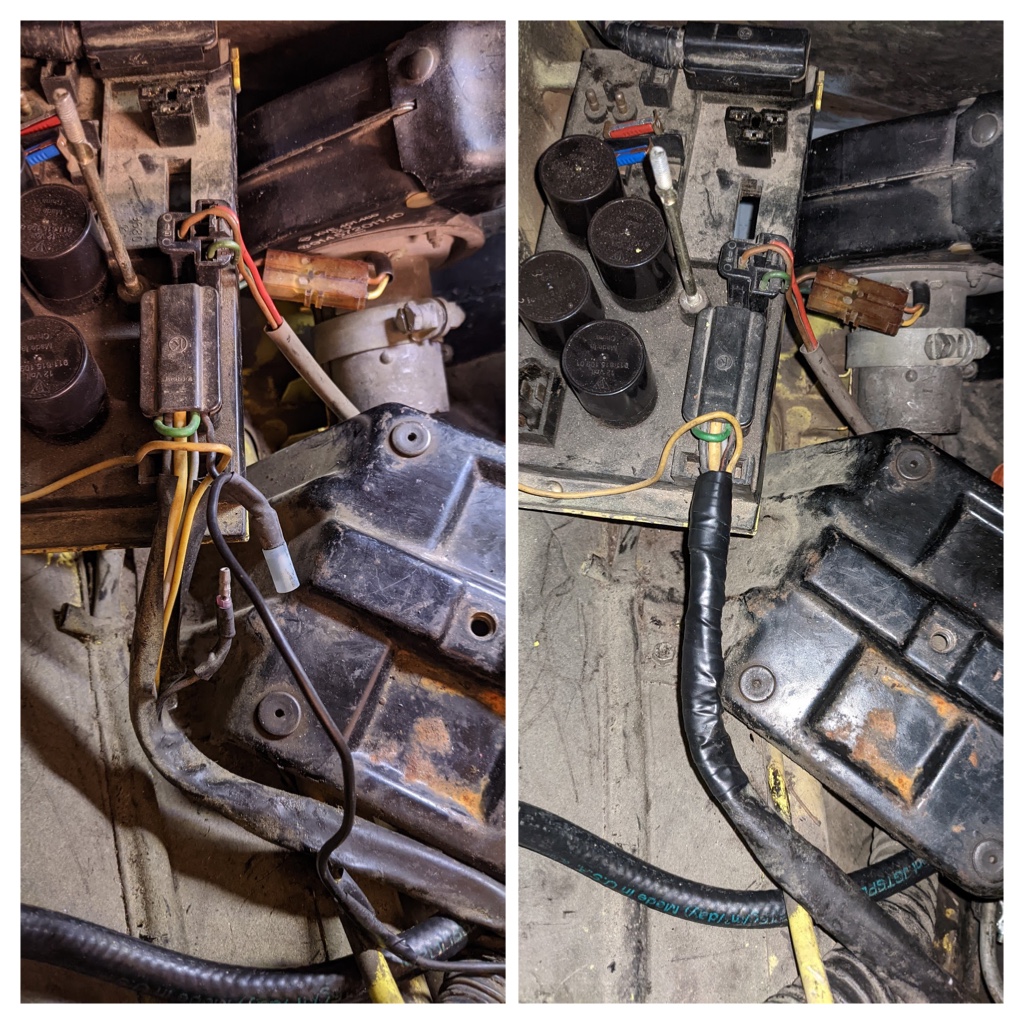

Business end and harness plug:

QUOTE(Van B @ Mar 27 2022, 07:38 PM) *
i'm looking at your relay board and i swear i am seeing something weird.
might be my imagination.
feel free to call me insane.
i don't have those circular relays, or at least not all of them.
its been about two years since i was last in there.
so i could be deranged.
i can check later, its a pain the arse getting the cover off because the aircleaner has to come off to manouvre it off (do you have that problem with that cover?).
but i am sure they are not there.
and i thought i came across something once that explained why.
with L jet all those relays are not used and instead its the gear over the other side screwed up under the battery?
from memory too only one of those regular type fuses sitting in there is needed.
one of them is just for the heated rear window, if you have a heated rear window.
but again i better go check on that.
i will see if i can take that cover off later and have a spy inside mine again.

QUOTE(wonkipop @ Mar 28 2022, 06:07 PM) *
They are not all used, I just find it to be a handy place to keep some spares lol…
The fuse I only realized after I bought it lol so, it’s now a reserve fuse as well I guess.
I bought all that stuff the day I brought the car home because the original stuff was in really rough shape.

QUOTE(Van B @ Mar 28 2022, 04:29 PM) *
ahh ok. yes good place to store them. (IMG:style_emoticons/default/smile.gif) (IMG:style_emoticons/default/smile.gif)
i got worried for a minute thinking, have i got something f'ed up in mine.
saves me tearing off my cover later this arvo. always not fun. (IMG:style_emoticons/default/beer.gif)

I pull out the VR and then pry out the cover. Still awkward, but I can get to it that way

Van B   And finally, I’m back on the original task. Got ...   Mar 27 2022, 07:37 PM
wonkipop   And finally, I’m back on the original task. Got...   Mar 28 2022, 04:14 PM
Van B   And finally, I’m back on the original task. Go...   Mar 28 2022, 04:32 PM
Van B   Business end and harness plug:   Mar 27 2022, 07:38 PM
emerygt350   Business end and harness plug: very nice.   Mar 28 2022, 08:49 AM
wonkipop   Business end and harness plug: i'm looking ...   Mar 28 2022, 04:07 PM
Van B   Business end and harness plug: i'm looking...   Mar 28 2022, 04:29 PM
wonkipop   [quote name='wonkipop' post='2991379' date='Mar 2...   Mar 28 2022, 04:49 PM
Van B   [quote name='wonkipop' post='2991379' date='Mar ...   Mar 28 2022, 05:08 PM
wonkipop   i've got a glovebox full of fuses. its not goo...   Mar 28 2022, 05:16 PM
Van B   Well you know where else you can keep two extra lo...   Mar 28 2022, 05:24 PM
wonkipop   some OT subject matter for light relief. and for ...   Mar 28 2022, 05:36 PM
wonkipop   back on topic. [b]@[url=http://www.914world.com/...   Mar 28 2022, 06:24 PM
