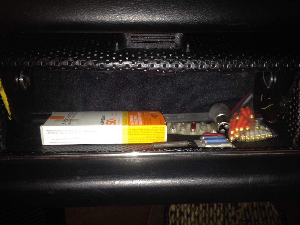

i've got a glovebox full of fuses.
its not good for much else. yet one another disadvantage of rhd. (IMG:style_emoticons/default/sad.gif)
the floor bin comes in handy. just as well the original owner was thoughtful enough to tick that box in the showroom.
to which i need to add some relays. if i can fit them in there!
