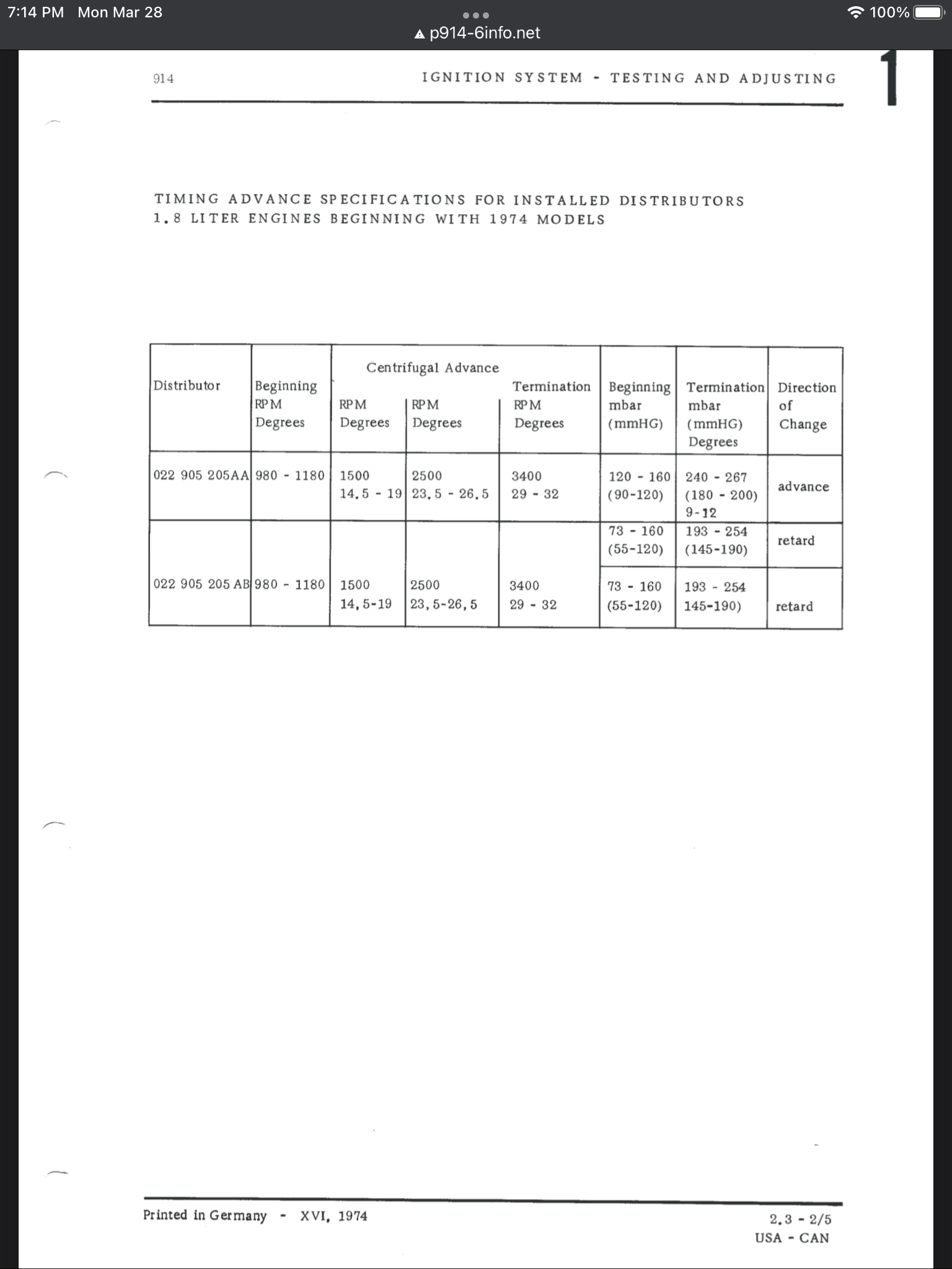

Regardless of the vac adv or retard, the centrifugal advance in a stock distributor will keep the advance at 27 degrees. Not sure pulling out 5 degrees timing would change the afr that much.
I will check my decel valve opening values tonight.
I am running a 2.0 Bursch exhaust. The 02 sensor is located about 10" downstream from the collector.

QUOTE(Brian Fuerbach @ Mar 28 2022, 03:43 PM) *
You might want to check this chart, we’re not talking about just 5 degrees
74 model would be using 205 AA
