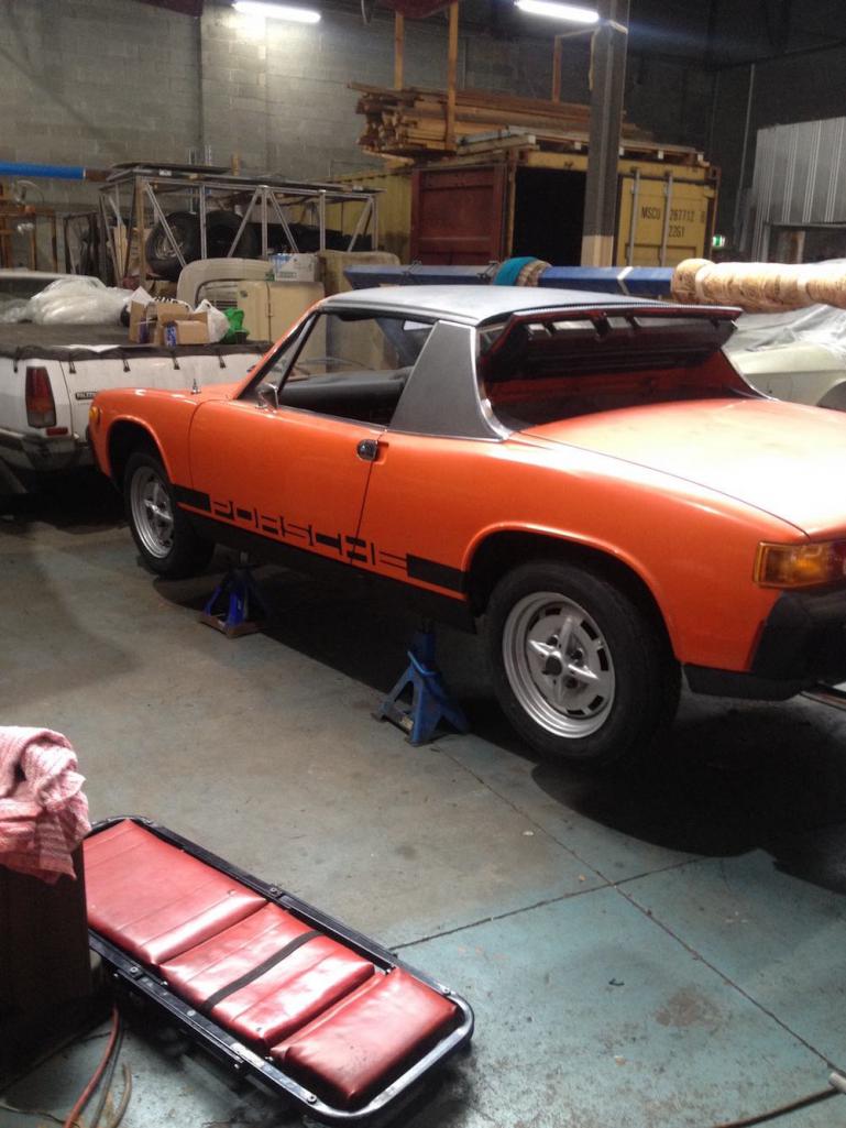

i'm a mere month away from getting the 914 back in and up on a hoist instead of jackstands to to the fuel pump/fuel line mods and a few other tuning touches again.
photo below.
march 2020.
914 nearly done and ute awaiting either burial at sea or major surgery.
