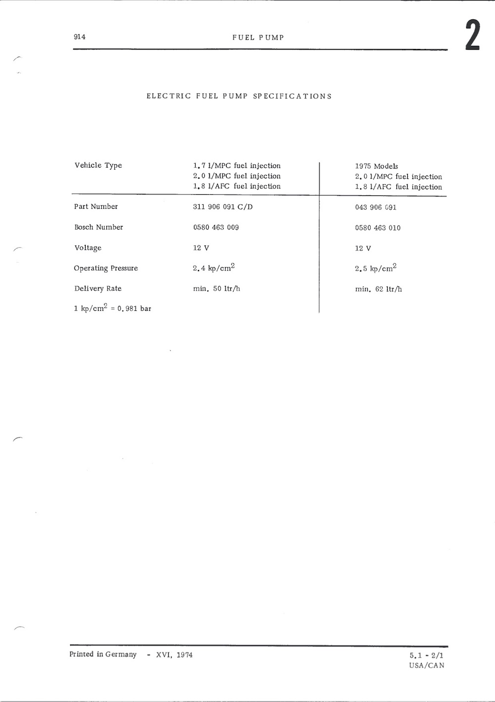

back on topic.
@Van B have you picked up the difference in original spec fuel pumps for front location that porsche themselves did back in 75.
its small difference, but they did beef up the fuel pump to deal with the longer circuit.
