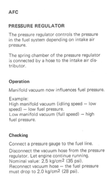

def adjust fuel pressure.
at low vac situations its 35 lbs.
and at high vac it reduces to 28 ilbs.
you test that as part of standard testing.

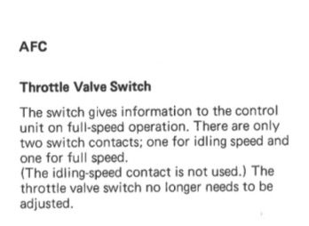

very definitely the throttle switch takes over at WOT.
just full on gives you fuel.
less clear about what tps does at idle (or throttle closed).
thinking about it, i believe its the AFM does it all.
when the throttle is closed the switch is simply sending a signal to the ECU that its closed. and ECU then knows this and does its routines based on other inputs.
i think only time ECU overrides the AFM is WOT and gives full enrichment.
