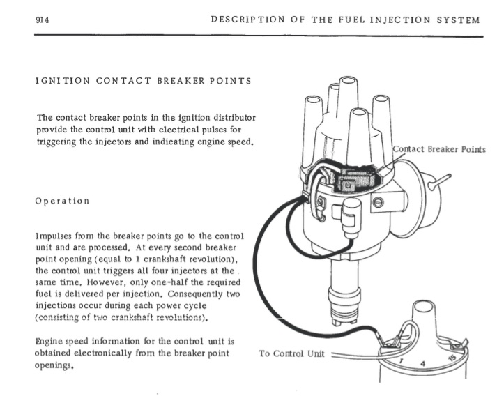

@Emerygt350 asked how does it know how fast the engine is spinning.
see here.
i like the way emery is curious about how the L jets are working.
the more stuff i read the more i came across explaining in historical terms just how hell bent bosch was on really simplifying the fuel injection system. anything they could do they did to not have an extra component in it.
