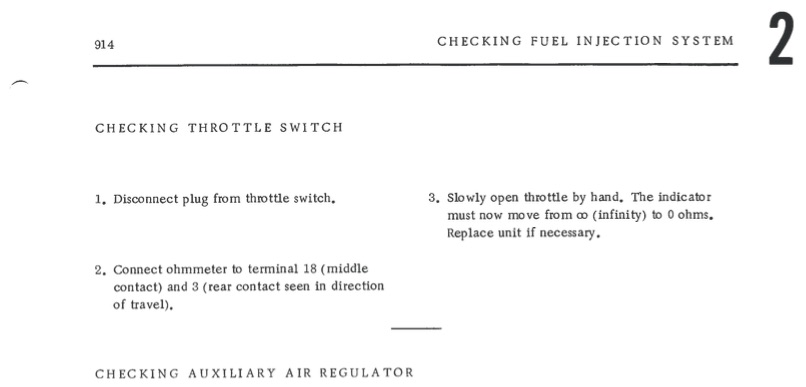

1974 1.8 with L- jet. Been playing with a wide band air fuel meter and noticed that when I lift the throttle the AFR goes to max value on the gauge. I thought it was supposed to go lean. I checked the throttle position switch and it checks out fine. Going to check the wiring harness next.
What else should I check? Decel valve?
