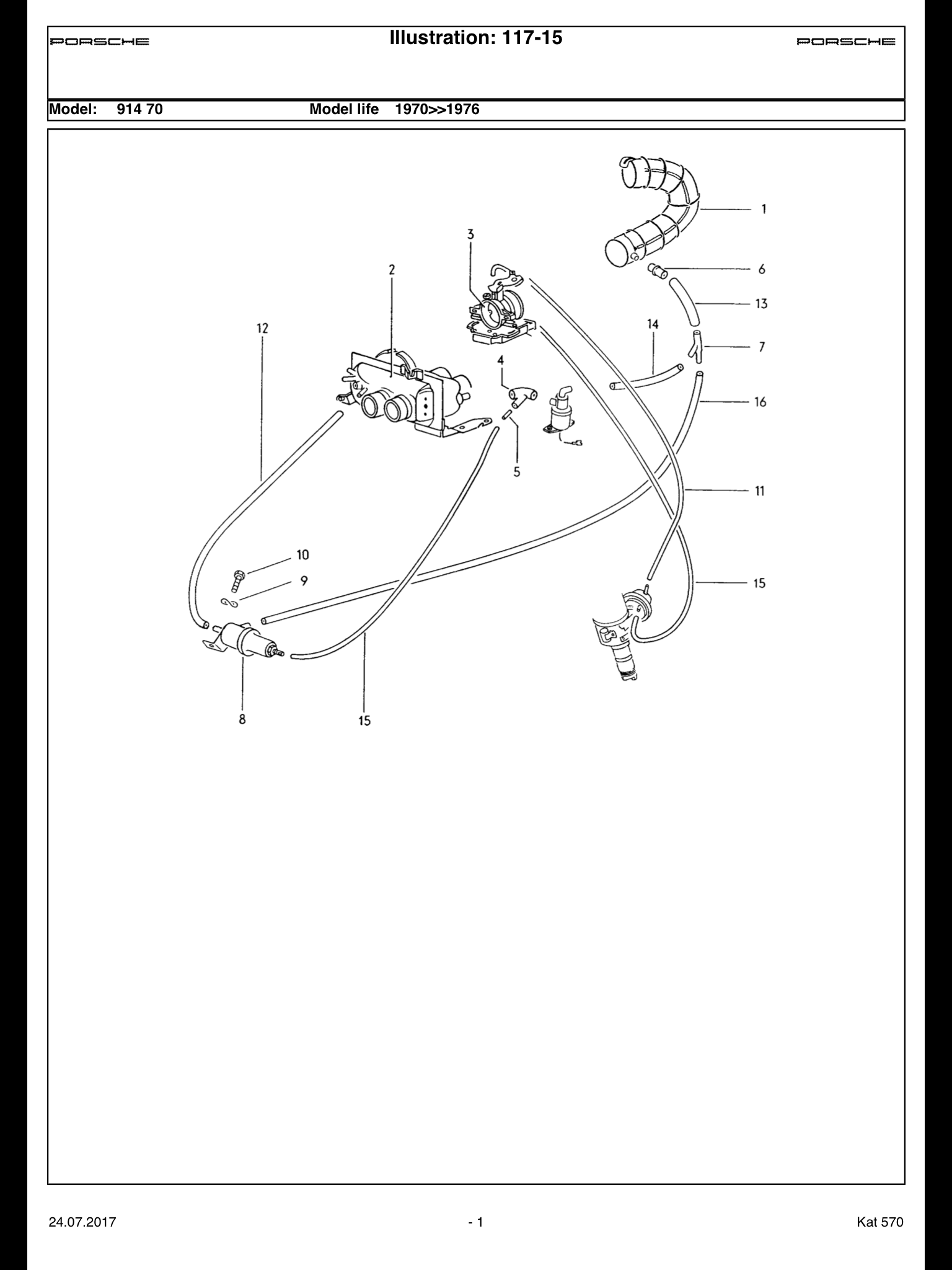

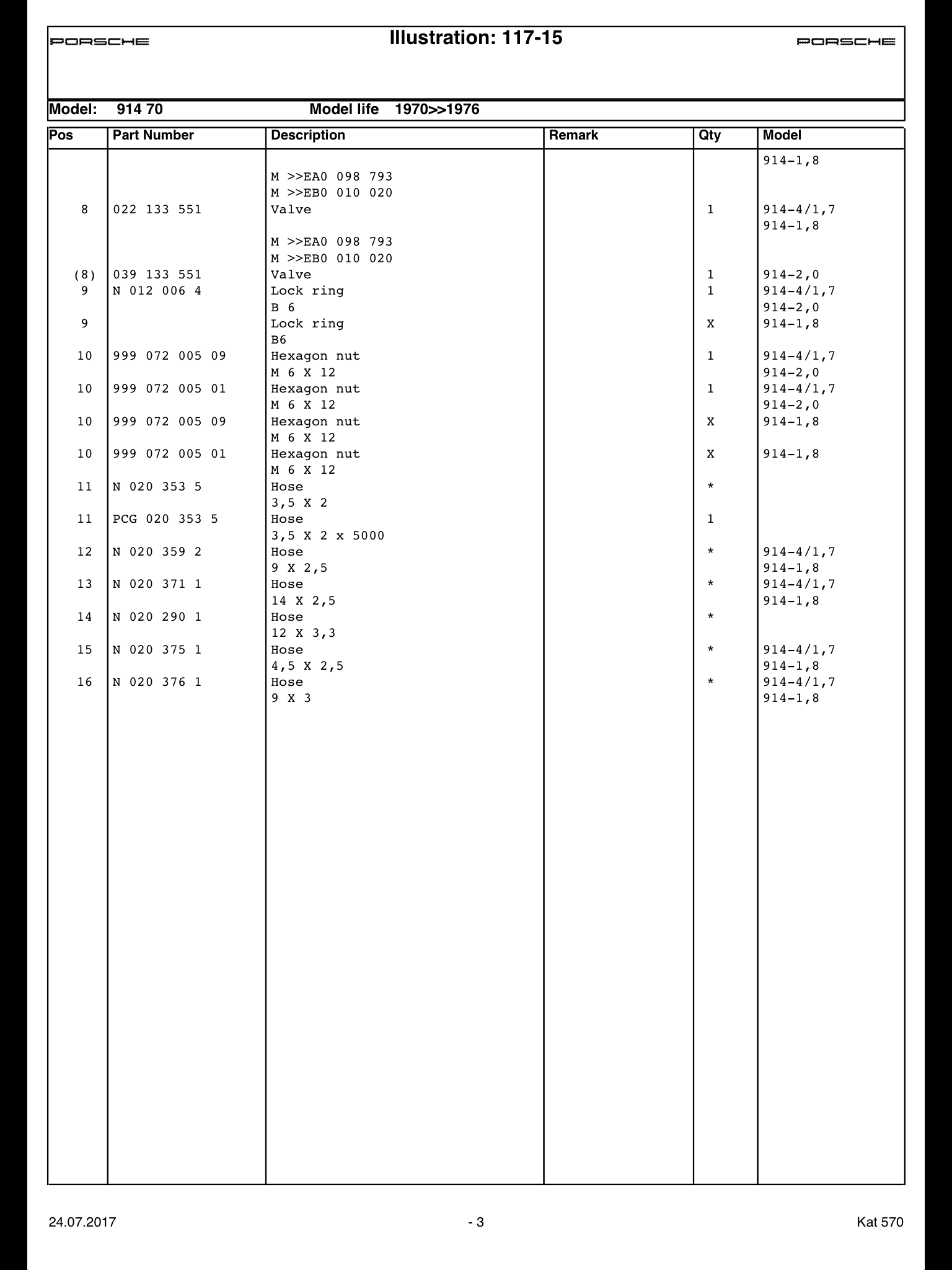

The parts manual can be a little weird on our cars due to the change in ‘75 that introduced the extra emissions junk.
But the one you have is the correct original as you know.
I had success finding a replacement by searching the Bosch number vs the VW number.
The B version is for ‘75 and it’s larger for egr purposes I assume.
