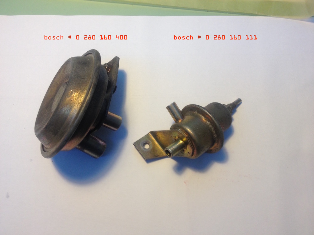

here is stuff i pulled off an old 911 intake system.
think its for a K jet?
salvaged a decel valve and probably only have to adjust spring pressure for the 914.
bracket is wrong orientation but probably adaptable.
also have an aux air valve, which looks almost like a 75 decel valve. (almost but not quite)
the aux air valve is hooked up to an aux air regulator, which is what we would call an aux air valve on the 914. they seemed to need to use the two to do cold start extra air for warm up.
they just made these kind of standard parts and they had a nipple closed or open, or a diapram maybe stiffer or a spring adjustment different and used them on anything and everywhere.
in australia there is a mob in queensland who can rebuild these things.
they open them up and recrimp them, so long as they are made of metal.
so if your WD 40 trick doesn't work and you can't get hold of one down here, they are a good way to go here if you have a core you can send them.
