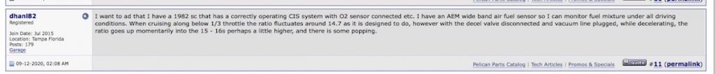

does this sound like your afr readings brian.
That’s opposite. That example is going super lean.
thats good,
its interesting for me then.
it seems to say with those 911s its not shutting off fuel, but the fuel is going to a lower level not influenced by air mass sensor (or equiv to afm, not sure what they have).
and since its not getting air its a pretty small amount of fuel?
must be what mine does when i back off gas without decel. just goes down to idle metering of fuel. i sure don't get what that pelican poster called popping. i might get some what i would call burble. so i doubt i get the rich thing fuel dump. probably get the opposite. not enough for anything much to happen except engine braking and a bit of fuel being expelled into exhaust and doing a little snap and crackle without the pop.
but there is no real combustion going on. its just spitting out a bit of fuel that is coming in. which is detonating in the exhaust. but its not a "real" rich condition thats occuring under true power combustion.
