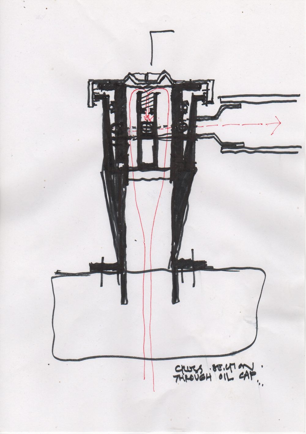

@Brian Fuerbach
there was a discussion recently around the oil filler cap.
you might have already read it brian.
http://www.914world.com/bbs2/index.php?sho...l44++smoke+test
i attempted a cross section sketch of the cap and posted in that thread.
but this is probably a bit closer to what its really like.
