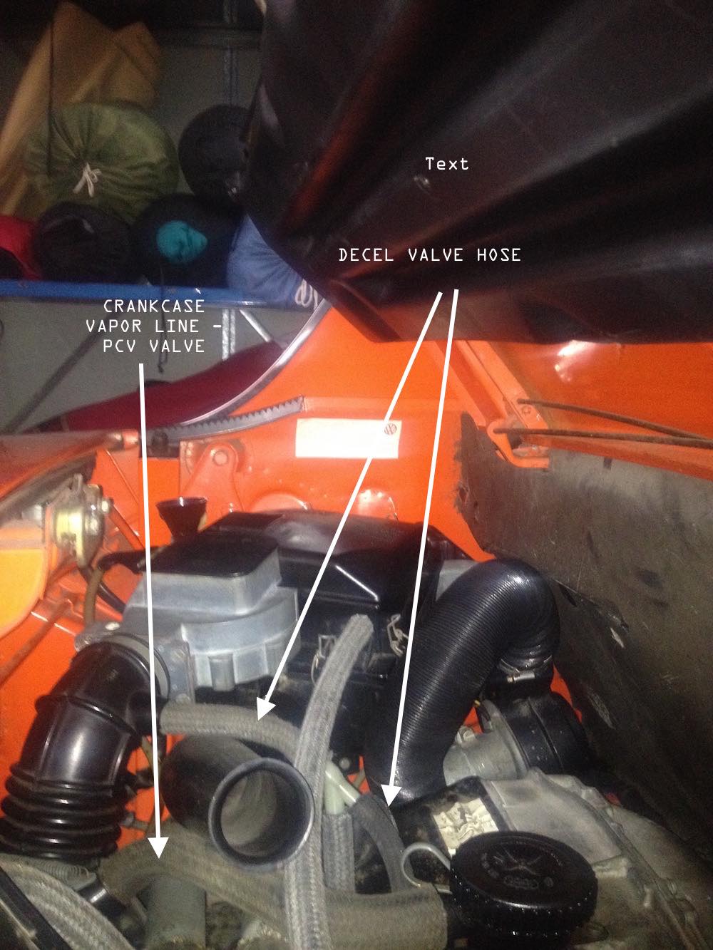

emery, here is a photo of mine.
brian's will be the same.
i was having the thought because of the location where the decel hose connects.
its between the crankcase vent hose and the afm. it could sort of want to draw air from either direction.
but brian's report of the condition of his pcv valve/cap kind of puts paid to my theory.
so unless his cap is misbehaving since he tested it, its not a valid thought.
