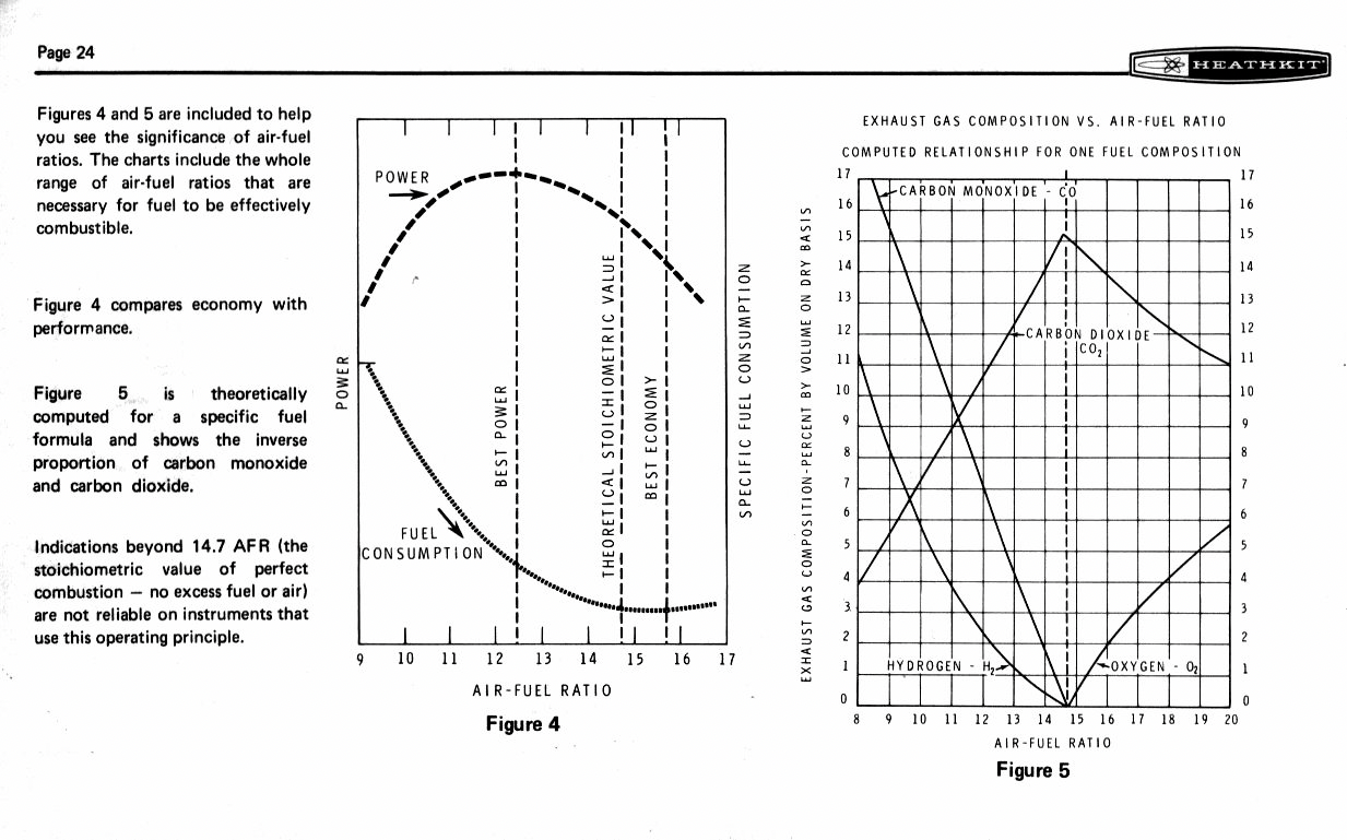

the afr measures oxygen to deduce effective combustion?
how does it do that - the effective combustion bit.
i've read a few things about 02 sensors but i don't quite get how they translate that into other information.
Charts like this are worth so much IMO.
thanks for that chart. i am going to study it now and make myself get this.

wonkipop   that chart was great. just as a translation device...   Apr 1 2022, 08:16 PM
Brian Fuerbach   that chart was great. just as a translation devic...   Apr 2 2022, 02:42 PM
Van B   Yes. AFR is the bottom scale. There are various g...   Apr 2 2022, 03:45 PM
wonkipop   @Brian Fuerbach although that specific chart has...   Apr 2 2022, 06:19 PM
