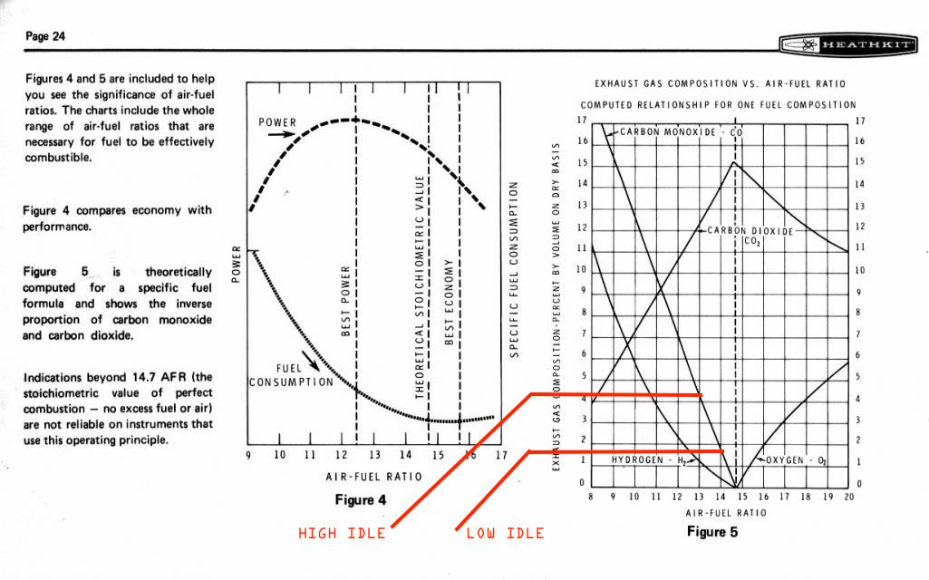

wonkipop
post Apr 1 2022, 08:16 PM
Posts: 4,803
Joined: 6-May 20
From: north antarctica
Member No.: 24,231
that chart was great.
just as a translation device.
(still ploughing through the scientific mud (IMG:style_emoticons/default/beer.gif) (IMG:style_emoticons/default/laugh.gif) )
dug out my old illinois emission test of 1990.
here is how it stacked up? - back then when it was still a teenager and the nice lady stuck a hose up its posterior.
high idle.
HC ppm 0128
CO% 4.20
CO + CO2 % 15.31
low idle
HC ppm 0635
CO% 01.88
CO + CO% 11.17
i was always interested in the stated limits of CO + CO2 % whenever i looked the test.
because it exceeded both. both were stated as limit of 6.00
but now the penny finally drops. i'm slow. it had to be over that figure? not under?
and under on all the others. HC CO.
you got to remember i am an aussie. no smog tests here.
no real emissions gear until the 80s.
hidden in details. tacho reading for high idle 2703.
no tacho reading recorded on test for low idle.

QUOTE(wonkipop @ Apr 1 2022, 07:16 PM) *
high idle.
HC ppm 0128
CO% 4.20
CO + CO2 % 15.31
low idle
HC ppm 0635
CO% 01.88
CO + CO% 11.17
How do these chart values translate to afr on my guage? Or do they?
Is 11.7 at low idle same as our gauge reading?
