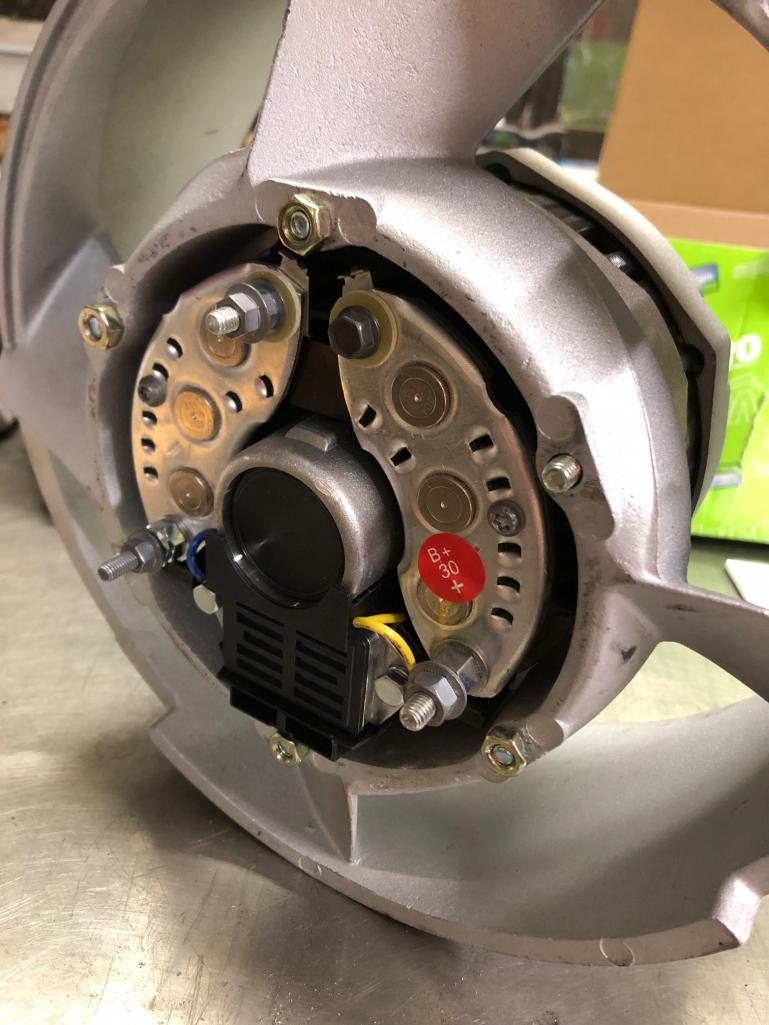

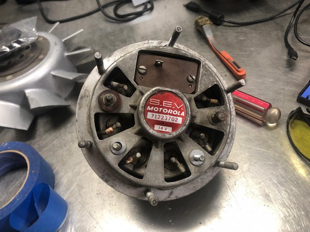

Slowly pecking away at the tub, getting distracted playing with the engine now.
The 1975 2.7 911 engine I purchased last year included an alternator that looks and feels a little rough. Diode readings were also indicating the need for a refresh, so being uneducated on the subject of 911 alternators, I ordered one from Autohausaz, and it turns out its the later style alternator that will need to have the housing hogged out for it to fit. (See 2nd photo, bolts are too short)
Now the question is, do I send my original Motorolla unit out for a rebuild (~$250) or do I keep this $330 Valeo unit, and pay to have my fan housing cut out (~$100+)
I believe my original SEV/Motorolla unit is 50(?) amps with an external voltage regulator (VR), and the Valeo unit is 75 amps with an internal VR. I've heard folks complaining about having the VR integrated to the alternator, since it sits on top of the engine getting baked by engine heat all the time. So my question is it really worth the upgrade for more output? I plan on running a set of vintage 55A Marchal auxiliary driving lights on the 914, so I'm wondering if my current Motorolla unit would be beefy enough to handle my demand. Any thoughts on this subject?
