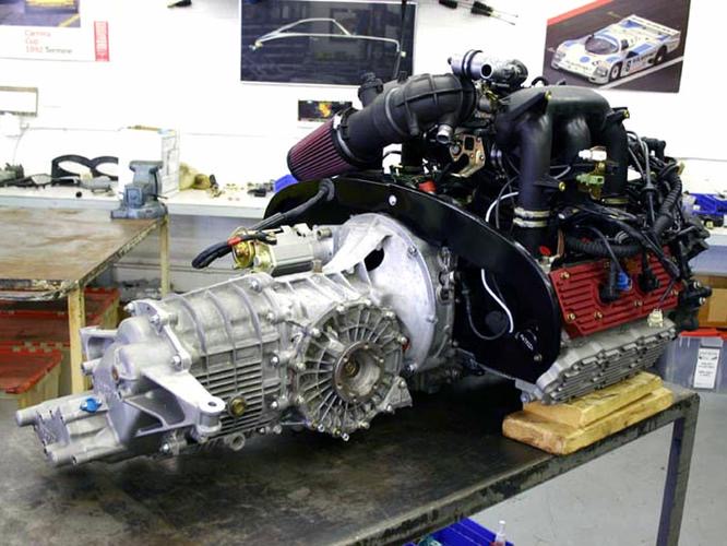

Took me too long to dig this up, but for perspective, here's a 3.6 with a 915
Intakes on this are also pretty tall but clear the engine lid (barely) the F360 looks taller still ...Can't wait to see how this project progresses (IMG:style_emoticons/default/aktion035.gif)
