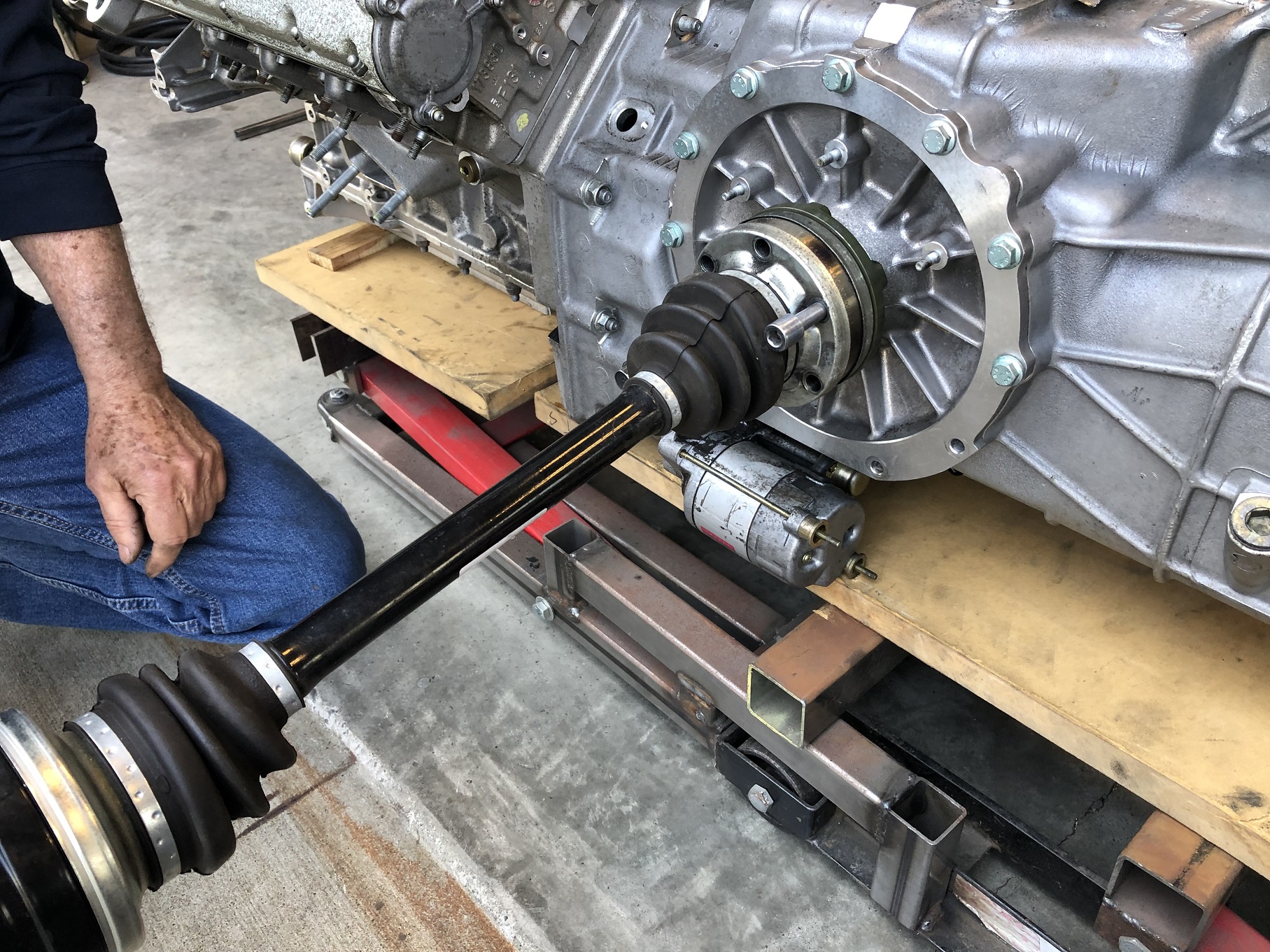

Let's keep with the "it was meant to be" theme. I've been sitting and staring at the drive train because, well, "Ferrari" and noticed the output flanges just begging to have something test fit to them. With my car apart, my axles were handy.
You now know the answer and can confidently state when you're next asked at this weekend's Cars & Coffee, "Why yes, Carrera axles do bolt right on to Modena trans output flanges."
You're welcome and can thank me later. (IMG:style_emoticons/default/av-943.gif)
Seriously though, I suspected this might be the case. Nice that it's now verified. Even better is that once I get my Boxster trans back, all I have to do is some simple math and I'll know the length the axles need to be. I suspect they'll need to be shorter than the Carrera spec, but we'll know soon enough.
A successful first step, and I'll take it!
