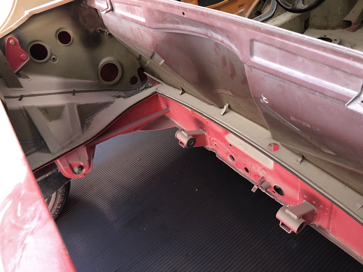

And now, some pics of the chassis:
Boy, I'm really unsure of slicing this one up for a swap like this. Take a look at what's already been done - and how nicely.
Let's start with the engine bay:
- 4-cyls mounts removed
- /6 mount installed
- oil tank prep complete
- prepped for A/C line
- suspension consoles reinforced w/bars to the firewall
- heater tube delete (some sort of electric heat was planned)
