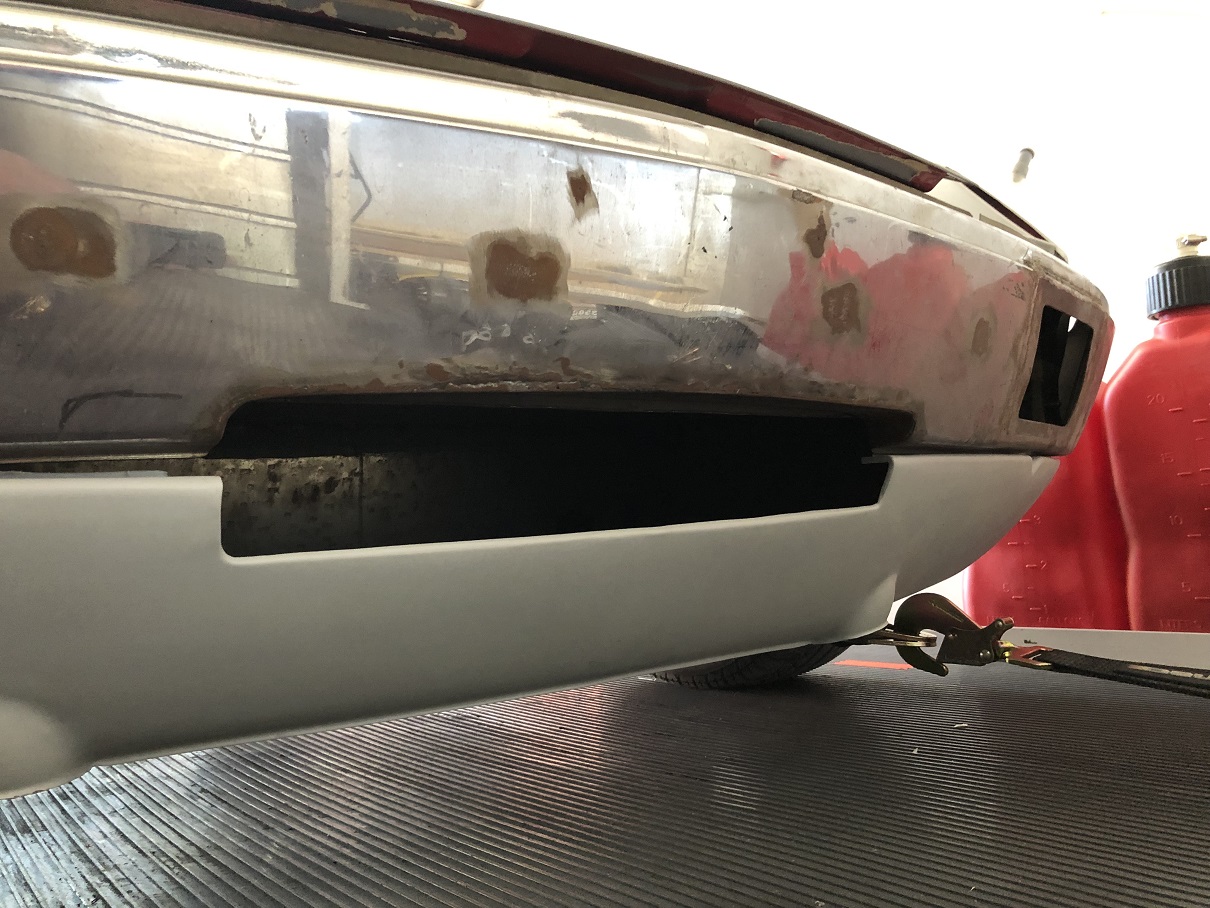

The nose, bumper and front valance are prepped for the GT opening. All steel, all the time.
And the fog light openings have been modded. Not sure what the plan is/was for them.

tygaboy   The nose, bumper and front valance are prepped for...   May 4 2022, 01:36 PM
tygaboy   Another view.   May 4 2022, 01:39 PM
tygaboy   Really nice gaps. But yes, somewhere along the way...   May 4 2022, 01:41 PM
