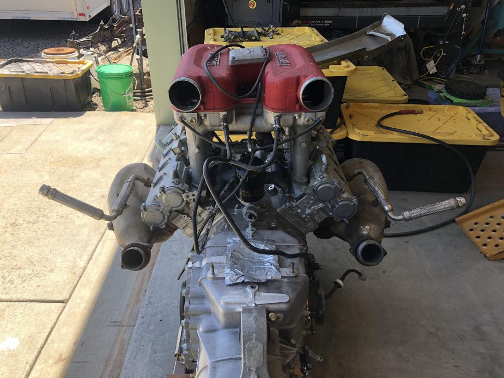

Fast forward to last week where I do just that. Here's what's in the Red Barn now: 3.6 liters, 400 hp and 275 lb/ft of Italian automotive porn.

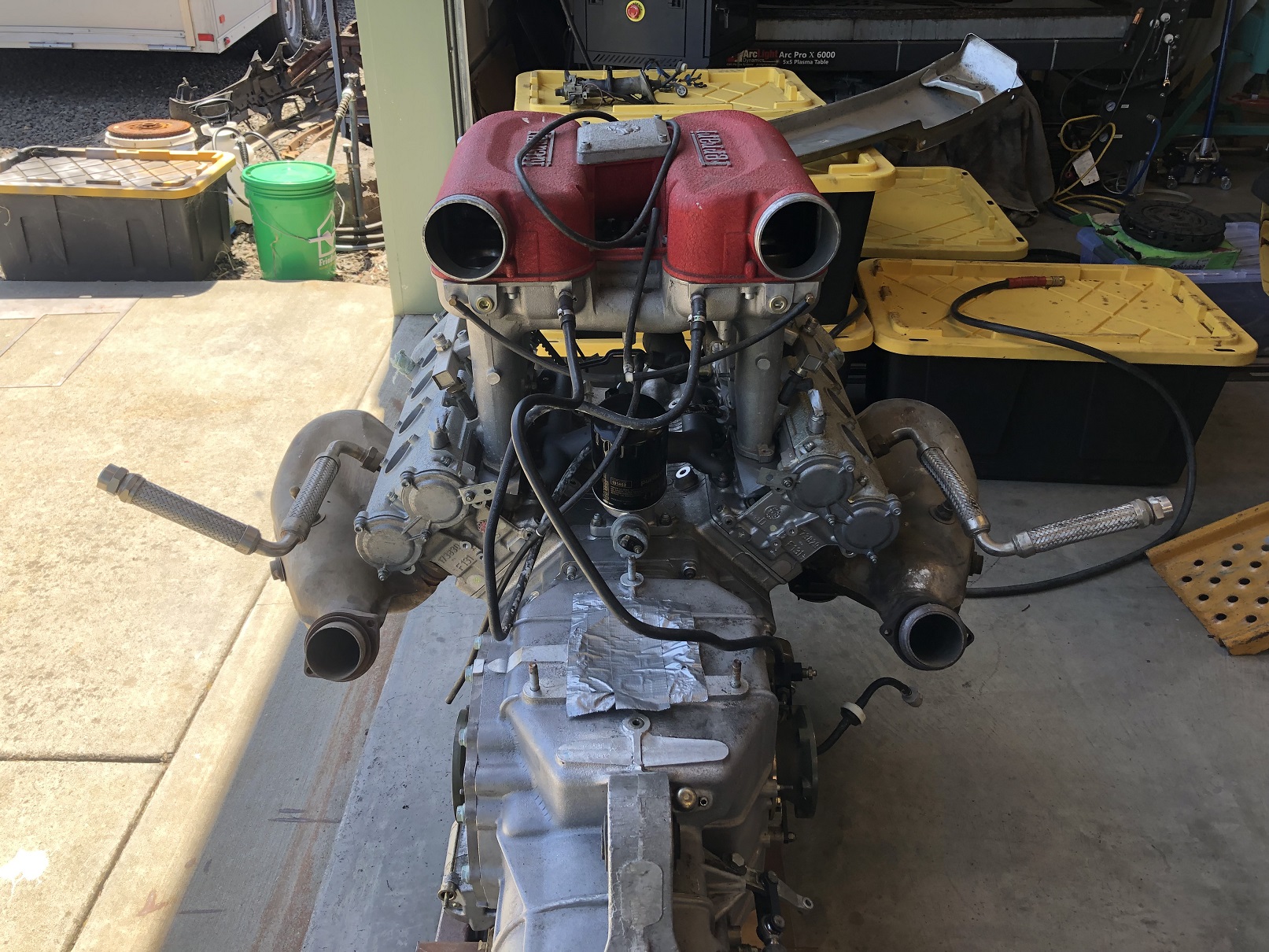

And in place, they look the business. You can see how the tubes sweep up, forward then back around.
I did some guesstimeasuring on the width and fore/aft size and in checking the space between the suspension consoles, they may actually fit. The real issue is that the O2 sensors stick out the sides so those may not fit.
This may be OK in that 360 headers tend to rot from the inside out, being wrapped in the shielding that you see here. It seems good ones, which these are (!) are quite desirable/valuable. We can sell/swap these and get a set to cut up to better suit the needs of this build. Or make something from scratch that's modeled on the factory tubes. We shall see.
Speaking of those O2 sensors, here's some interesting stuff you likely don't care about: This engine has a flat plane crank, which is what virtually all 4-cylinder engines use. So what did Ferrari decide to do? Run this engine as two, separate 4-cylinders!
There are two of everything: cam sensors, crank sensors, knock sensors, O2 sensors, fuel tanks, fuel pumps, throttle bodies and engine ECUs. Yep, two. Each ECU runs 1/2 the engine.
Won't this just be the best, trying to figure out all this stuff? (IMG:style_emoticons/default/wacko.gif)
